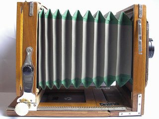

I have a couple of old cameras which have relatively solid bellows but have some wear at the corners. I'd like to add some thin cloth along the corners to reinforce and protect those thin areas. I'll attach a shot of a FKD 13x18 which was made like that.
So, the question is: have you done that and how? I've thought about bookbinders tape, linen tape, silk strips, silk ribbon - and maybe adhering it with Pliobond. I distrust tape in general since the adhesive is often problematic. Thoughts?
