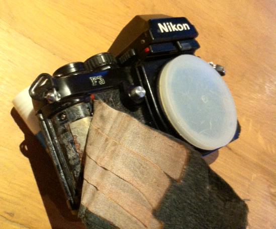

I was offered an old Nikon F3 with two focusing glasses (type K and type G4) for Euro 25 (USD 28). The only problem was that the leatherette was coming loose at the edges. But the camera was supposed to be in good working order.
I already have a Nikon F3 looking and working as new. So I really don't need a second one. But then, my daughter (16 years old) is suddenly showing an interest in analogue photography, so this could be a nice extra camera for her to use and practice. I have somewhere an old 50 mm f2 Ais lens that doesn't look nice either (but in good working order) to complete the test set for her.

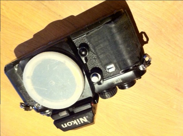

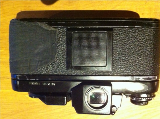

I took the bate and said yes. The camera was mailed to me and it arrived today. First of all, the batteries were dead so I didn't know if it was in working order. But the shutter did fire at 1/60 with the manual release button (next to the lens). I went out and bought me two new watch batteries type SR44W / 357 (but a pair of A76, S76 or DL1/3N will fit also). I put it in the two batteries and the camera came alive. All the shutter speeds sounds good and it is as fast as my own F3. The LCD screens is also working, as is the light meter.
But, it looks really terrible on the outside taped up like this:
It doesn't look even that bad in these images (made by iPhone) but believe: it looks and feels bad enough. I won't send my daughter out on the street with this one.

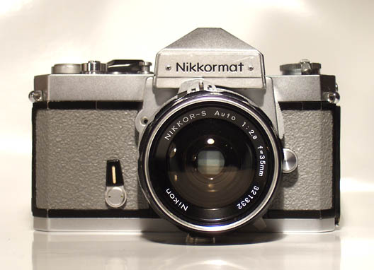

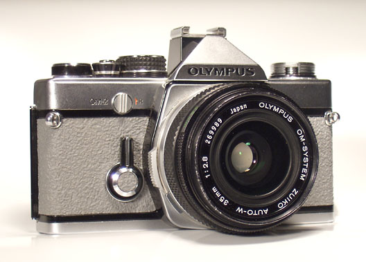

So, now I'm thinking of refurbishing it. I found a very nice DIY kit to replace the leatherette, see: http://www.cameraleather.com/nikonslr/
I like the grey Griptac for USD 14.00. Gives a nice look and it doesn't have to look original.

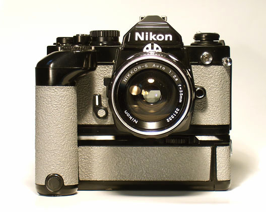

Look like this (on an other model Nikon and an Olympus):
leatherette_grey_Griptac_Nikon_motorwind.jpg leatherette_grey_Griptac_Nikon.jpg leatherette_grey_Griptac_Olympus.jpg

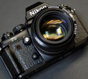

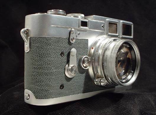

An other nice on (to me) is the Granite Kid Skin (Goat). It looks like this on a Leica M3:
I haven't decided yet, but this real leather costs USD 44.00. And since my F3 is black (not chrome as most examples on http://www.cameraleather.com) I think the lighter Grey suites better.

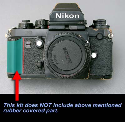

4) I didn't realize it at first, but the rubber grip is missing. They used extra thick tape to mimic it. Anyone got any ideas how to fix this? Has anyone a spare lying around? Or should I leave it out? The grip itself is formed on the camera body, the rubber grip is only a layer of rubber (it seems?).
At www.cameraleather.com they offered a kit wrapping all around the rubber grip (loosing the red stripe):
Owners of the F3 have the option of replacing the rubber grip and red stripe with a single strip of leather. Those who have made the change love the way it looks. Nikon_F3_no_grip_red_stripe_rubber-cover.jpg
Your kit can also be cut like the factory covering, leaving the rubber grip section alone.
This would be a solution but aki-asahi.com doesn't seem to have this option.

The grip isn't going badly, it is missing at all! Its replaced with extra layers of tape.
By the looks of it - compared with my "new" F3 - it's just a thicker layer of rubber glued to the cast.
If I get a full sheet of leather to wrap around the grip as well, I can just put some extra fillings beneath it. For instance with the suggested "rubber cement" (don't know yet what it is). See: http://aki-asahi.net/store/html/Nikon-F3/camera-body/install/01/01.html

It's easy to re-cover the Nikon... the only slightly difficult part is cleaning the old covering off. As for the grip, I would use a few layers of tape instead of the camera leather, because that area is high-use and will show more wear.

But the grip I'll try to get original if I can't get a new skin that goes all around the camera.

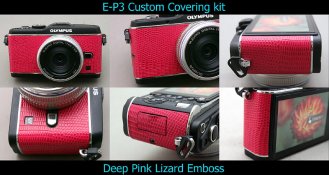

I showed it to my daughter and we are probably going for "Yellow Lizard Emboss (cow hide)" or "Deep Pink Lizard Emboss (cow hide)" since the F3 has a black body. The other option was the "Granite Kid Skin (Goat)" from www.cameraleather.com as showed above.

I received a new rubber grip from Nikon for my F3 body, so I'm now gonna order me a leatherette kit. My daughter chose two colors: yellow and pink.
See these color examples:
The first option was the Grey Griptac mentioned above:
Since she couldn't choose between these colors, I would like to post a small poll. Which color do you think suits best my Nikon F3?
