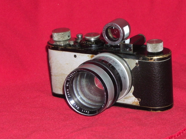

The cover has a couple of large pieces missing from around the lens mount...yes, I consider it ugly. What now?

Just for fun, I thought you might like to see a reskinned LTM. The improvement was beyond huge!! The super-tack skin is an absolute marvel. It transformed the camera.
J
It just came back from the CLA, & now I'm waiting for the new covering....
