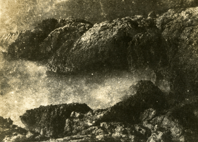

But I've already made a successful ClBr emulsion and basically the only differences were ripening time, refrigeration and adding Potassium Iodide final. Even though it lacked a bit of speed for enlarging, it worked beautifully for contact lith print (see image below).
Denise, here is a contact lith print made from home made paper negative onto home made paper with home made developer... even my 5x7" camera is home made !... :smile:
My goal is not to seek perfection of a clean, crisp and sharp realistic image, I'm rather looking for "atmosphere"...
