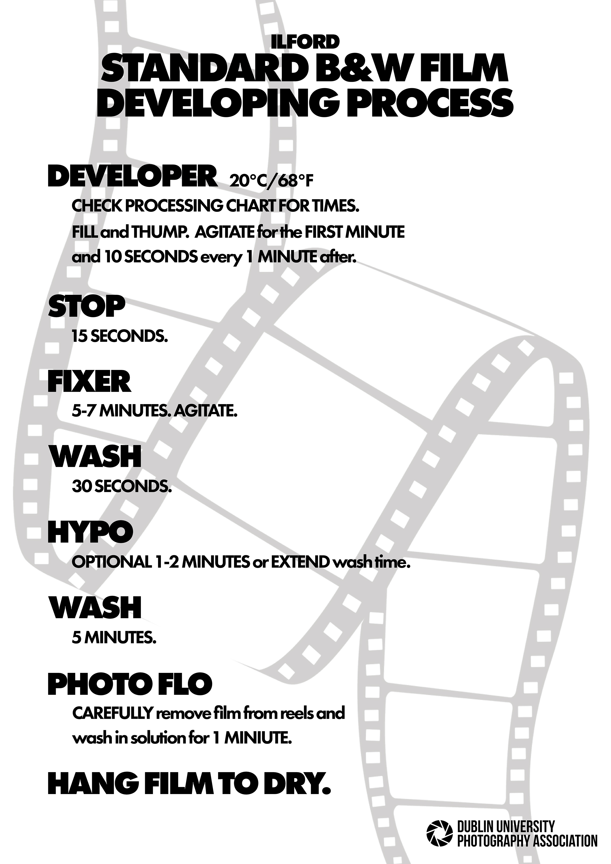

I made this for my college darkroom a while back. It might be helpful.

There we go, thank you!! Those guides are exactly what I needed (I lost my old Kodak guide somewhere along the way).

Cool chart, Henry!
My only nit-pick is that it should read "Hypo Eliminator" or "Hypo Clear" instead of Hypo.
Hypo is Fixer to us Oldtimers. 🥸

Fair enough. I think my first version had Hypo Clear, but I don't know why I removed it. Then I removed the Hypo Clear step and prewashing altogether because we weren't using it, and it confused people. I also have one for C41 and B&W print development.
