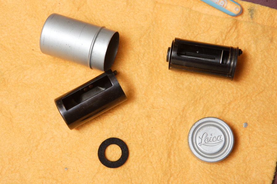

I have quite a few FILCA's that need re-foaming. I will probably just get sheets of the funny foam to make the new gaskets that seal the ends (see inset).
Anyone have a good suggestion for the adhesive if I cant find any self sticking sheets of foam. I think these are brass.

I've used Weldbond Contact Cement. The one with the little brush in the cap.
Do yourself a favor a buy a cheapie set of tiny model airplane paint brushes to apply the contact cement.
And once you open the contact cement, it's only a matter of time before it eventually hardens and turns to rubber over the course of six or eight months.
I like the Weldbond brand. It's very effective. Apply it to both surfaces. Allow it to dry for a few minutes. Press together.
I've also lately been using Loctite Clear Silicone sealant for certain items.
In your case, I'd probably start with the Weldbond Contact Cement -- available in Home Depot, Lowes and similar stores.
