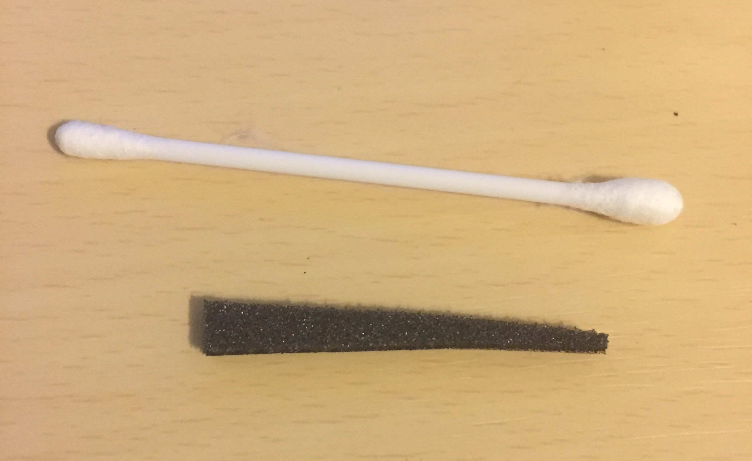

Just finished refoaming my Mamiya 645 1000s with 2 kits from USCamera.
While the Mamiya M645 Body Custom Light Seal Kit worked fine, I cannot recommend the Custom Mirror Cushion Kit.
There are 3 strips in the kit; a front mirror bumper and 2 side mirror bumpers. The front mirror bumper is a simple, skinny rectangle and it works fine after you laboriously scrape off all the rotten foam and adhesive (and let me tell you, that's a trick!).
However, the 2 side bumpers are for some strange reason, wedge shaped and, in my opinion, simply too thick at the leading edge for the task at hand. After I installed them and engaged the MLU, the mirror was under a pretty big strain to lock-up and the foam was being pushed up above the nylon skirt that sits directly above the bumpers.
No matter how I tried to reposition them, they simply did not work for me. Maybe I am an idiot, but I gave up and installed two thin rectangles of denser, self adhesive foam I got from Michael's craft store in their place and the camera was happy.
Adding to my frustration was a lack of good documentation on their website. The text only page was not real helpful and gave no indication of the wedge orientation, although it could only have been large edge to the front of the mirror box with the taper toward the hinge of the mirror. Interestingly, on the kit instructions page, there was an inquiry asking for assistance in determining the orientation of the wedge-shaped foam bumpers that was posted back in February with no corresponding answer from the company or owner.
I think I will look elsewhere for my next refoaming kit...

Please avoid these imitation kits. The seal pieces and pads in the 645 (there are a total of 12 if the kit was prepared---or copied correctly from my work) are in some cases less than 1mm different in length and the side damper pads look nothing like the above. I've gone to great lengths to make it as easy as possible to identify and use these seals. If you're curious, please contact me at jon_goodman@yahoo.com
