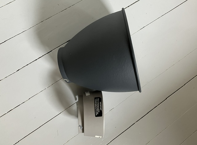

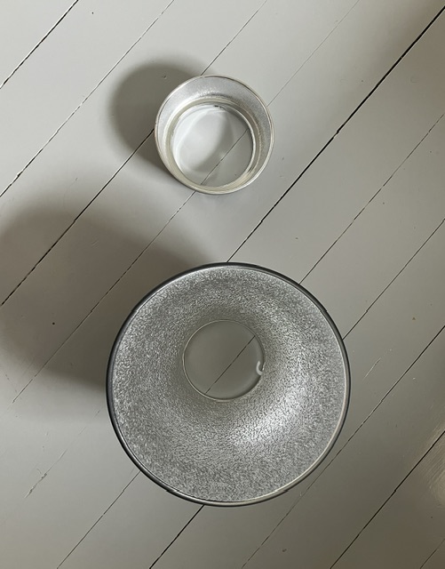

I bought the Elinchrom High Performance 48° 260mm reflector.
Compared to a 160mm reflector.
Here are some readings with Sekonic L-308X:
1 meter distance, ISO 3. Elinchrom RX 600 at maximum 600Ws.
Bare bulb f/6.3
Small reflector 160mm f/7.1
Large reflector 260mm f/16

That is more than 2 stops over the umbrella reflector!🙂
With 3 600Ws strobes and the ”High Performance” reflectors I think it is possible to do some good exposure wet plates. But as Koraks stated above the light will be hard. I think really harsh. I have to experiment some.

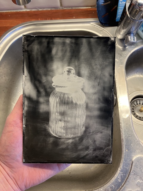

I did a test plate with one Elinchrom 600RX strobe and the 260mm reflector I mentioned earlier in this thread.
This is one pop with the strobe. Distance 1 meter from subject. A Zeiss Triotar 150mm wide open at f/3.5 on a 5x7 plate.
I am surpriced that the strobe light of only 600ws was strong enough to give me that bright exposure! The highlights developed in a couple of seconds when pouring the developer on plate.
And as you can see the light is really harsh with blown highlights and I think it is hard to control the highlights with a reflector and poor dynamic range of collodion, especially subjects with high reflective surfaces. I was using a black backdrop and my intention was making a completely black background but it reflected a bit of light.
I will try some more plates.
600Ws from 1m distance is a lot of light. I only ever had with 200Ws (two pcs) to work with. Based on what you show, I see no magic in the reflector, to be honest. It's about what I'd expect from a 600Ws unit with regular parabolic reflector at close distance.
Well, yes. I also see lots of fog and oyster shells. Have you tried developing a little less? This is the usual way to control the highlights and it'll also reduce the fog. More exposure + less development = lower contrast. This works very well with collodion. Borut Peterlin published some videos about this a few years ago; they're very nice demonstrations of the principle at work in wet plate photography.
Getting rid of the oysters is a matter of more thoroughly cleaning the edges of the plate.

It is a reused aluminium plate and not in very good shape. Rinsed and used just for experimenting. I have a whole box of them, dont ask why😅
I will try reducing my developing time👍 This was 12 sec. Is it actually fogging on the plate? If you mean all the light patches around the jar it is the reflections/highlights in the satin backdrop you see.

You made me look again; I stand corrected. The edges that were masked by the holder look clear. So it's really in-scene exposure. I think what's throwing you for a loop here is that satin may be black, it can (apparently does) still reflect UV. I.e. it may be blacker to our eyes than it looks to a collodion wet plate.
Having said that, your exposure sure is ample. Feel free to dial it back down if you find that you still have too much background after cutting back development time to reel in the highlights. It's a matter of taste, of course, but I think the scene would end up looking better if you actually allow the backdrop to show up; the texture is kind of nice...
