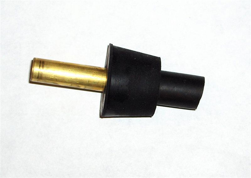

1) First, I see many people saying that you should absolutely get the foot pump for the Expert drum but some of them warn that if you aren't careful, the lid can blow off and one guy even says he lost a tooth doing it. Others say they damaged their expensive Expert drums with the foot pump. Even Jobo warns about this. It quickly became apparent to me that not only do you NOT need a foot pump, but there is a much better and less expensive alternative. Air compresses and, as pressure builds up, the top pops off - possibly suddenly and with force. But water doesn't compress - at least as a practical matter for this application. So I just went to my local hardware store and got a 50 cent rubber stopper that fit the drum's opening and a piece of brass tubing that fit my darkroom sink hoses. My hardware store had stoppers with and without a hole in the center. Either one is fine but I got one with the hole because that would help keep a drill bit on track when I bored it out to fit the tubing. I drilled the stopper a size smaller than the O.D. of the tubing and inserted the tubing into the stopper. It's a tight, firm, non-slipping fit. The tubing can be plastic, copper, or brass but my hardware store only had it in brass. (See the attached picture.) The black hose you see on the end of the tubing that will go into the 3010 tank lid is not necessary. I just clipped a bit off my sink hose and put it on so that it would avoid any possibility of scratching the tank as I inserted it and it also acts to hold the assembly together which is also not really necessary. But the stopper will not slip on the tubing even without it.
To use it, just push it in the tank lid opening and turn on the water. The top pops off perfectly in a second to two. Air is being compressed if you use it this way so it is similar to what a the air pump might do but probably a bit more gentle. But if you want a perfectly smooth lift off of the top, just hold the stopper loosely in the tank hole and fill the tank with water. When the tank is full, just press down on the stopper and the top will lift off beautifully with no pop at all because no air has been compressed. The water lifts it perfectly. Air acts like a spring and when the top breaks free, it can pop. But water just lifts it up gently.
