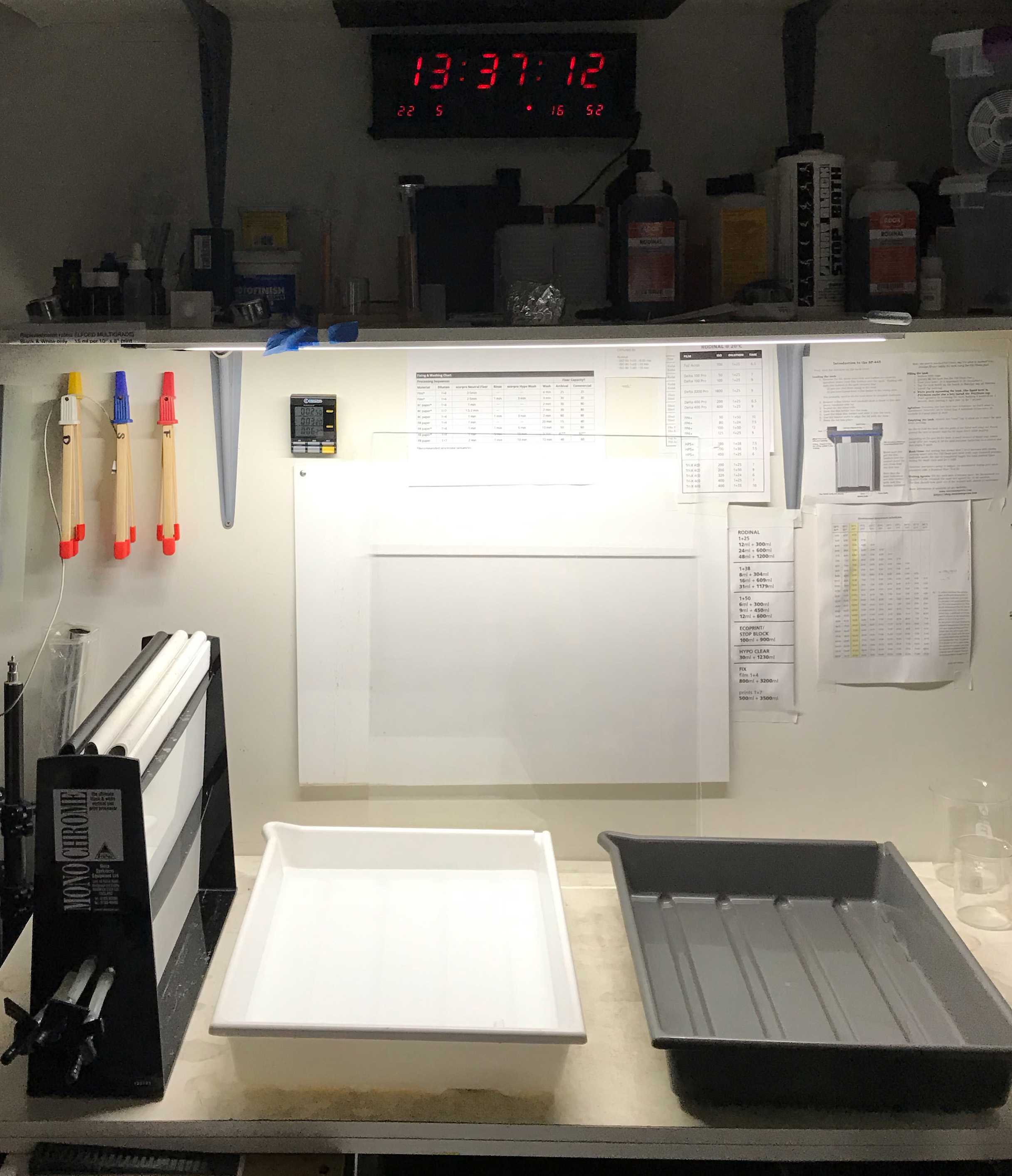

What notes do you have posted for reference in your darkroom? It may be because I don't often get a chance to print/develop and I need refresher notes or it may just be because I'm a nerd but I have notes around both my wet and dry areas to reference. Generally these are made by me but some are copied from various resources. All are laminated (nerdy).
Wet area notes
-Development times for HC110
-Development times for C41/E6
-Dilutions for various volumes
-Printing times and dilutions
Dry area notes
-Color head settings that correspond with filters
-F Stop chart from Way Beyond Monochrome
I still need to make a form showing what enlarger lens I need for various size negatives (I print from 35mm up to 4x5 and I have to google this every single time) as well as a cheat sheet on toggling different settings/functions of my RH Designs Analyzer Pro. I'd also like to make a sheet or two that gets me started quickly. Essentially I'd like something that told me that for each negative size there was a shorthand for each print size that would give me starting points such as enlarger height, lens, and anything else that might get me printing more efficiently.
My question to you is, what types of notes do you have printed around your darkroom and why?
Thanks,
Omid

A handy note/chart I have posted by my Omega D5 is the bellows extension for each range of lenses. And I keep a post-it on the fixer jug to record how many rolls have been done, as well as a note for how many prints have been made with the current developer.
written on the wall: 75 = 24. 75F is usual temp of the room so every process starts there.
I sharpie tally marks on working bottles to indicate number of rolls and prints processed.

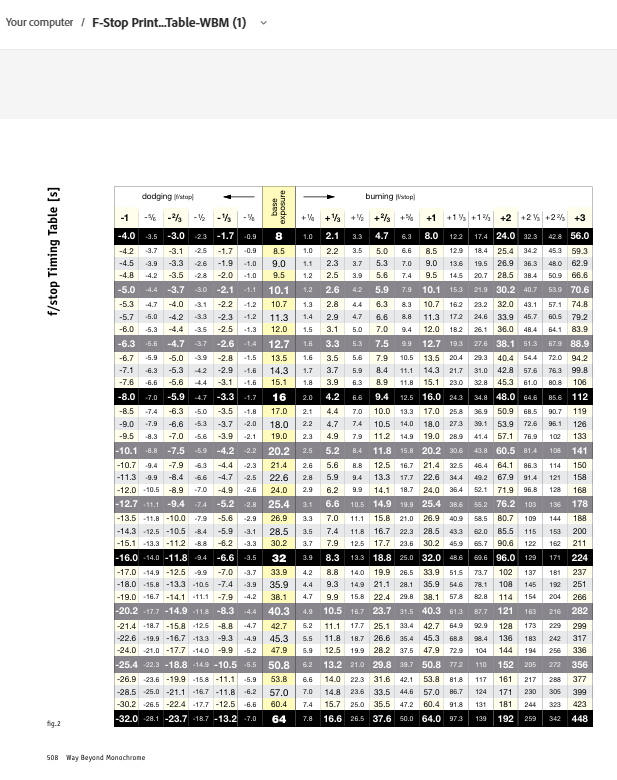

Courtesy of @RalphLambrecht 's Way Beyond Monochrome, an f-stop printing table - which he has kindly shared here before:

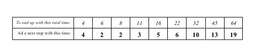

And a test print progression that is a practical progression of 1/2 stop exposure times that I created myself.

I have notes pinned up for the recipes for a few of my most often used developers, like Thornton 2-Bath and PMK.
I used to have that in my previous darkroom. Notes all over the place, ranging from recipes for stuff like Van Dyke brown to pyrocat to filter values for color films used, collodion formulas...the works. Then we moved and I decided I wanted things to look a little quieter. So the notes are gone, but the computer now has a more prominent place in the darkroom. So whenever needed, I look up e.g. developer formulas which I keep in Excel files, massive dev chart is always easy enough to pull up and I've got direct access to the archive of digital & scanned images for reference. Overall I like it better this way, although the notes had sort of a comfy feel to it, too.
I have a small white board on the wet side to keep notes for different processes and replenishment rates for developers. On the dry side I use post-it-notes on the wall for whatever is important at the time.
On the back of the darkroom door: "Did you turn the Safe lights OFF?".
I actually have a lot... I made up some decent looking ones in Google Sheets, exported them as PDFs, and had them printed at Staples on nice paper and in color before mounting them to the wall for easy reference.
  • Film dev times for (N-1), (N), (N+1), and (N+2) for all of the B&W film and developer combos I regularly use. Actually time I updated this, since I've added Pyrocat HD(C) as a preferred developer for 120 FP4+...
  • Full instructions with temps/times/agitation for the various color film development I do (C-41 film in ECN-2 chemistry, ECN-2 film in ECN-2 chemistry, E6 film in HC-110 + ECN-2 chemistry)
  • Recipes for all the DIY stuff I keep on hand (ECN-2 dev/bleach/fix/stabilizer, Instant Mytol, E-72 paper developer)
  • An expanded stop-based printing chart with base times from 4 to 64 seconds in 1/12 stops, and +/- 2 stops dodging and burning in 1/3 stop increments, right next to my enlarger control panel
  • Process notes with quantities for various print sizes to make Kallitypes on HPR. Also have one up for New Cyanotype, though I've given up on that process for now and will be trying traditional cyanotype instead at some future point
I also have a dry erase whiteboard between the enlarger and the sink, which I will frequently use to sketch out dodge/burn schemes, or take down quick temporary notes while I work towards making work prints or final prints.
And I keep records of all my B&W printing in a spreadsheet, with a page built out to easily print them on an index card, so I can spit out a handful of those and stick them to the whiteboard with a magnet if I'm going into a print session needing to come out with specific prints and specific sizes that I've already made in the past.
I'm religious about keeping detailed notes in pencil on the back of my test strips and work prints so I can examine them and learn from them when the paper is dry and I can look at it under brighter room lights outside of the darkroom.
All of this is probably overkill, but I am a data engineer and analyst by trade, so I guess my tendency towards wanting to live in a world where useful data is available has translated into my hobbies :D
