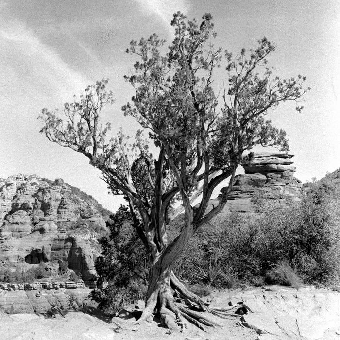

Bettersense, I once massively overexposed a shot because of forgetting to put an IR filter in place. The exposure factor was something crazy like 8-10 stops. I took several shots that way... and blindly developed them normally.
Let's see, here it is. Just a neg scan, I can't find the print. But I did nothing to the neg, no bleaching, no anything. It is pretty much black to the eye. I am not joking, it is black. Totally on whim I threw it on my scanner and was completely surprised at how much detail there was.. in, what, a 0.1-0.3 density range?!!!
Ah film! If you are a competent photographer, it will amaze you. If you are an incompetent photographer, it will amaze you even more :wink:
