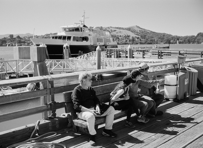

@albada thank you! Here's an example where I'd like to use one:
The dark clothes and hull became pure black because they are in shade. And yes, a blue filter will lighten them because shade is lit by bluish light. But as Doremus warned us above, skies will become white (unless burned). Doremus also stated that your meter is "a (very) rough starting point." That's because the spectral response-curve of the meter probably does not match that of film, even when you meter through the blue filter.

I'd like to keep using my usual films,
What was the film and the developer you used for this photograph? Have you tried more conventional methods of taming the contrast, like adjusting the exposure index of your film or developing to a lower gamma?
I quite like your image, though. It think that if you reduce the contrast you'll lose some of the atmosphere in this photograph.

@Romanko great question. Yes, I am usually quite happy with the desired contrast level with HP5+ in Xtol by dialing it the exposure + development time. But I am bumping into limits of what's possible using Fomapan 100 and 400. I love their spectral sensitivity characteristics, they paint a quite distinct B&W picture of the world, but the density range I can play with and the shape of their toe is not nearly as generous as with HP5+ so I was looking for another lever.
Foma 200 is better, but at the moment only the defective batch is available at the usual retailers (freestyle, B&H, etc).
