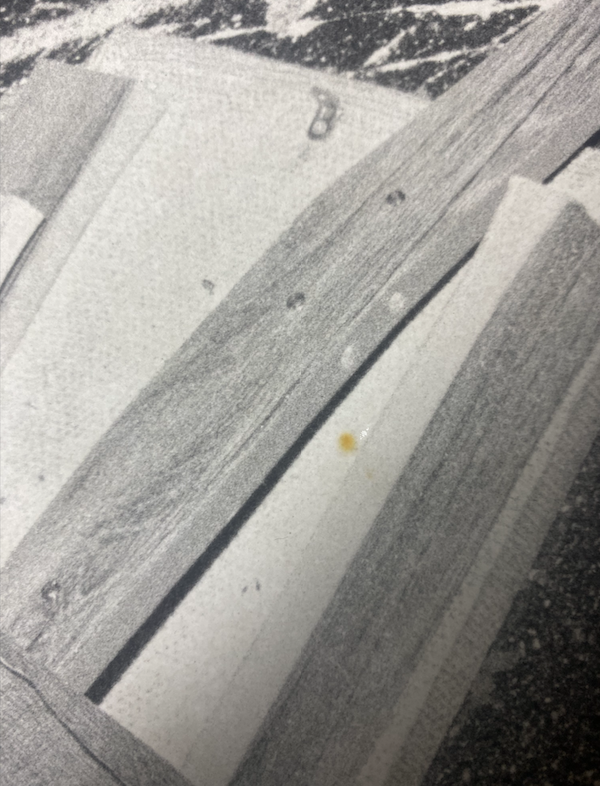

Hi everyone,
On Saturday I made 5 prints in 20x24 and went to tone them with selenium on Sunday. Before starting the selenium bath, I noticed that two of the prints had a reddish stain, almost rust-colored, and it raised a few questions about the real cause behind these marks...
Here’s my process:
  • Dev: Ilford Multigrade 1+9, 2 minutes
  • Stop: Acetic acid 100% — 13 ml per liter, 1 minute
  • Fix: Ilford Rapid Fixer 1+4, 2 minutes
  • HCA: 1+4 from a stock solution made with sodium sulfite (1kg for 10 liters), 4 minutes
  • Selenium toner: Kodak T-55 formula, 3 minutes
My main doubt is whether this stain comes from insufficient washing, exhausted fixer, or maybe some rust from the drying rack.
Any ideas on what could be causing this stain?
If the drying rack has rusty spots, then that's a logical explanation. The other steps in the process are unlikely to produce this particular color.
Did you go directly into the selenium
The way I read his post, he noticed the problem before the print ever came near any selenium.

So, my washing process here goes like this:
After the fixer I wash for 20 minutes, then I run the HCA, wash again for another 15 minutes, then do the selenium, and finally a 25-minute wash.
But this print was developed and went through HCA on Saturday, and I only did the selenium toning on Sunday. I actually noticed the stain before toning. After finishing the HCA, I put it to dry on the rack, then on Sunday I rehydrated it in a water tray for about 15 minutes and only then did the selenium.
One thing I’m suspicious about is that in my lab I don’t have an archival washer—it’s really hard to find one here in Brazil… I wash the prints in larger tray with a siphon. For 20x24 prints I usually use 30x40 trays, often washing more than one sheet at a time. That’s why I suspect the issue might be something in the washing stage. But since Koraks mentioned that it’s unlikely for stains of this kind to come from the process, it might actually be rust. Still, I haven’t been able to easily find rust spots on the drying screens.
Such a stain could only have formed in such a short time if you had contaminated your already washed prints by splashing some drops of fixer on them. Rust is the most probable cause.
But since you're asking, I wonder how many prints, and at what size, do you fix in one litre of fixer? And how long do you wash your prints?

A platinum printer was having a heck of a time with spots on his prints...drove him almost nuts.
Then one day he pulled the chain to turn on the safelight above his trays before turning off the main lights -- and noticed a little rust falling off the chain. Problem solved.

The water supply to my house is an iron pipe, you can get particulates from them, although my pipe is heavily calcinated, The water board has replaced the pipe to my boundary in polypropylene, I need to dig up my drive and do the rest.
Various Iron compounds are often used in water treatment, maybe filter your water.

I use nylon/ poly plastic type screens they use for drying fruits and vegetables. They can't rust and store very easily when not in use.
I was also going to suggest looking for sources of corroded iron-related materials that could be getting dislodged and falling to the print surface, or being kicked up into the air and settling back down. A reddish color can also sometimes be from oxidized developers - perhaps some developer was mixed up from powder nearby?
