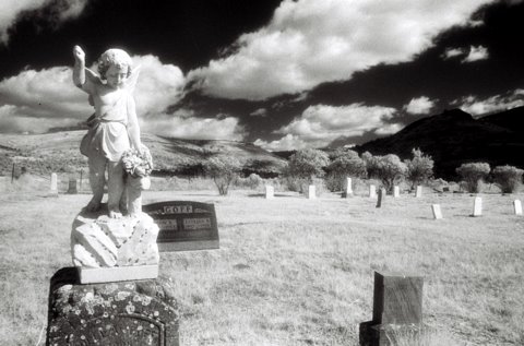

The medium red (#25) is adequate for B/W IR. However, a dark red (#29) is even more effective.
Kiron Kid
