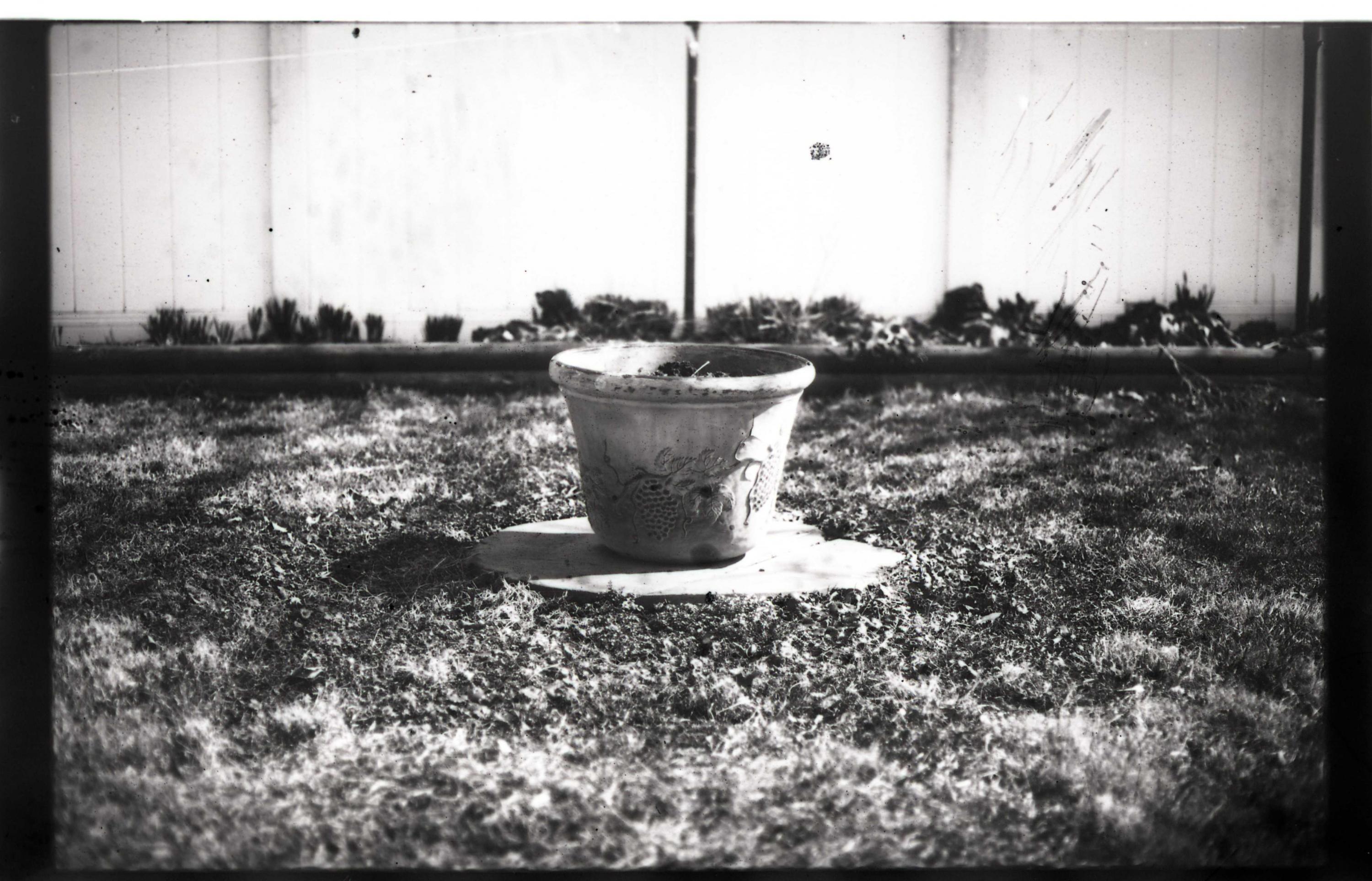

Cleaning out my darkroom I found a half-used spool (~50') of +40 yr old film Valca 6 DIN Ortho (my Dad's) inside a box w/ no can, it was just out in the open. Being ever so curious I decided to try an experiment: Can it be "recycled?"
With the lights on, I fogged the heck out of it and developed it in Dektol 1:1. Once it was all black I washed it well, put the cover on the dev. tank and bleached. It was then washed well again and left it overnight to dry. The next day I put it in my slr and did some exposure tests in my backyard:
fast lens, long exposure: f 1.8 for 7 secs on a nice and bright sunny day. Dektol 1:1 for 3 min/wash/fix. I wonder now how other stocks would do, for example would a PAN still be panchromatic afterwards? Anyone ever played around w/ this?
What did you bleach with? I suppose the drying afterwards was done in darkness?
CuCl for 15 min. All steps after bleach were done in darkness.

that's it... although just for the record, the film was already ruined when it was found.:whistling:
here's the process at 68F:
1) You'll need old film that has been fogged or accidently exposed
2) Fog it under a strong light source
3) Spool it onto a tank reel & develop in strong developer until completely black (metallic silver)
4) Wash 2 min
5) Placed lid on tank and put in CuCl bleach (from B&H) for 15 min (silver halide, AgCl I suppose?)
6) Washed for +5 min
7) Opened inside the Darkroom and hung it to dry overnight.
8) Spooled it into a cartridge and did exposure tests.
I figured it be very slow working off reversal re-exposure as my guide. My initial guess was about 15 secs full daylight, but half of that was needed.
9) Developed & Fixed.
