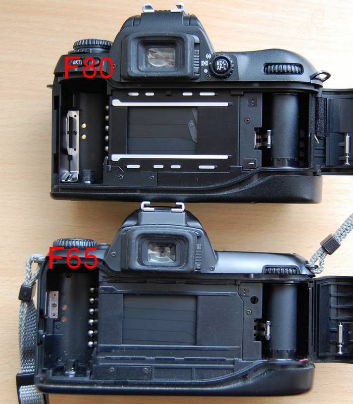

Well, I scanned the negs and after 4 or 5 frames, the lines began appearing again. Is this just bad luck or an unfortunate coincidence?
Initially it seemed to me that something other than the camera(s) is to blame, but after re-reading this thread and after looking at some of my own Nikons I'm not so sure anymore.
You seem to have ruled out the processing (different labs), the film (different films) and the scanning (lines also visible by other means).
The cameras then? The Nikon F80 and F65 seem to share the same roller design. Other Nikons are slightly different. They all work fine for me, but could it be that you are just extremely unlucky with your particular cameras (rollers)? Maybe try get your hands on an F100/F90(x)/F801(s) and see if the problem persists?
If not the camera either, then what? Then you're left with re-checking your 'line of investigation'. Me personally I would start by reconfirming that all the lines in the scans are also on the film proper. 'Pilot error' is sometimes too easily written-off, I've done it myself many times. Not saying that you're doing something wrong, just that it is important to keep considering all the possibilities.
