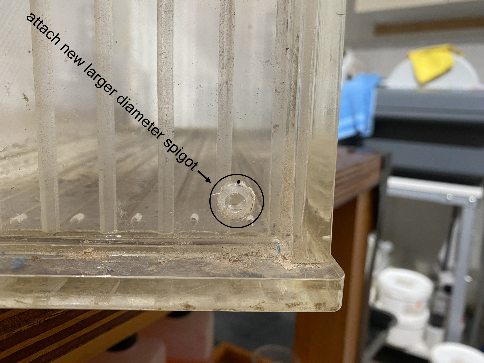

I have a Nova Academy washer that hasn't been used for over a year, and is currently lacking the spigot attachments as a previous repair failed. Once I've cleaned up the unit, my plan is to attach new spigots of a slightly larger diameter. I realise Nova supply the Acrifix 116 solvent cement, however other products that appear to perform a similar function have greater distribution.
- this looks like a strong possibility, which I've seen mentioned on Photrio previously: https://ema-models.co.uk/liquid-solvent-cement-300ml.html - which appeals as the company also supply acrylic tubing in sensible quantities for the job.
Has anyone else here had experience with a similar refurb?

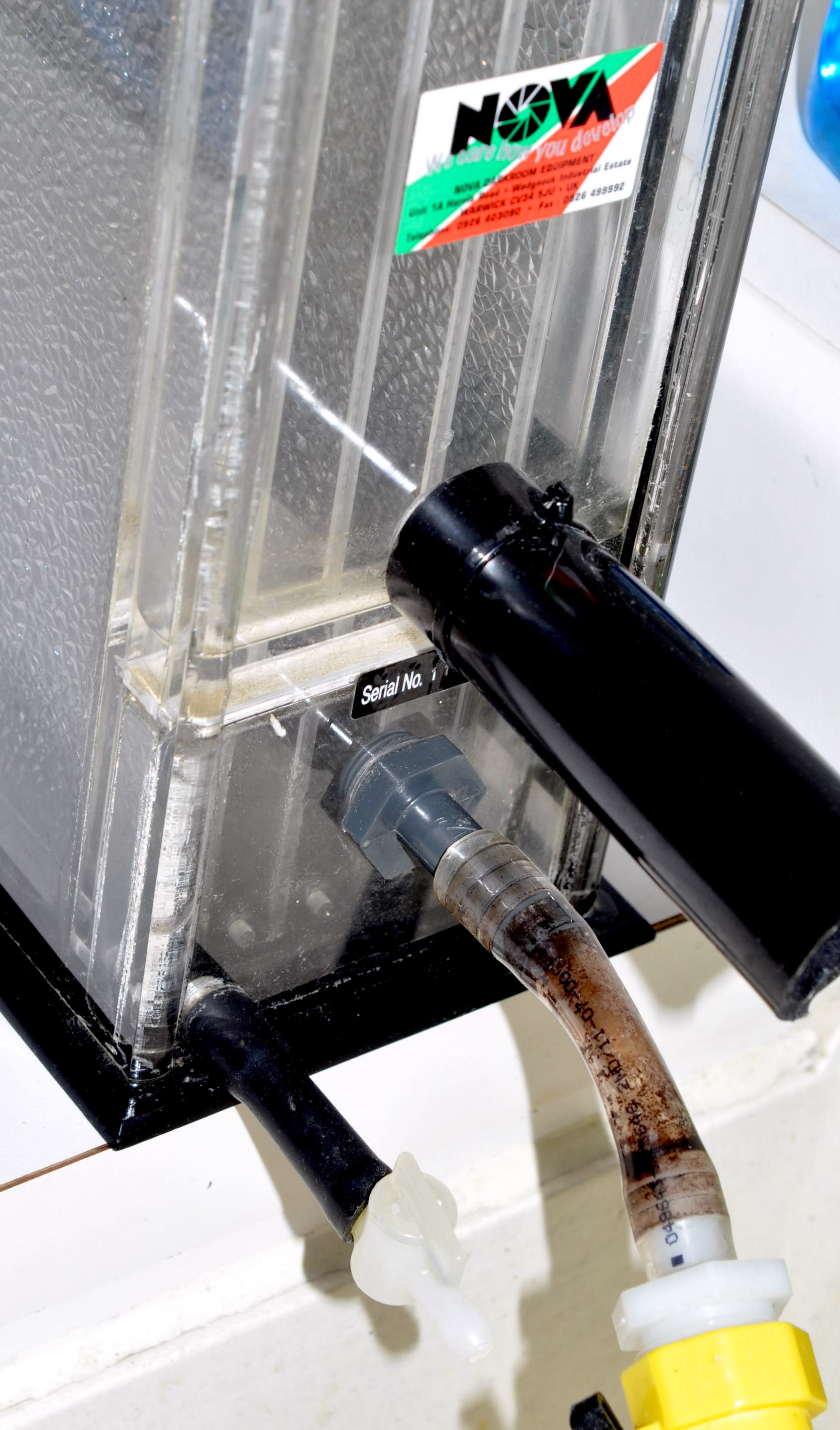

On mine the spigot attaches to a short piece of hose.

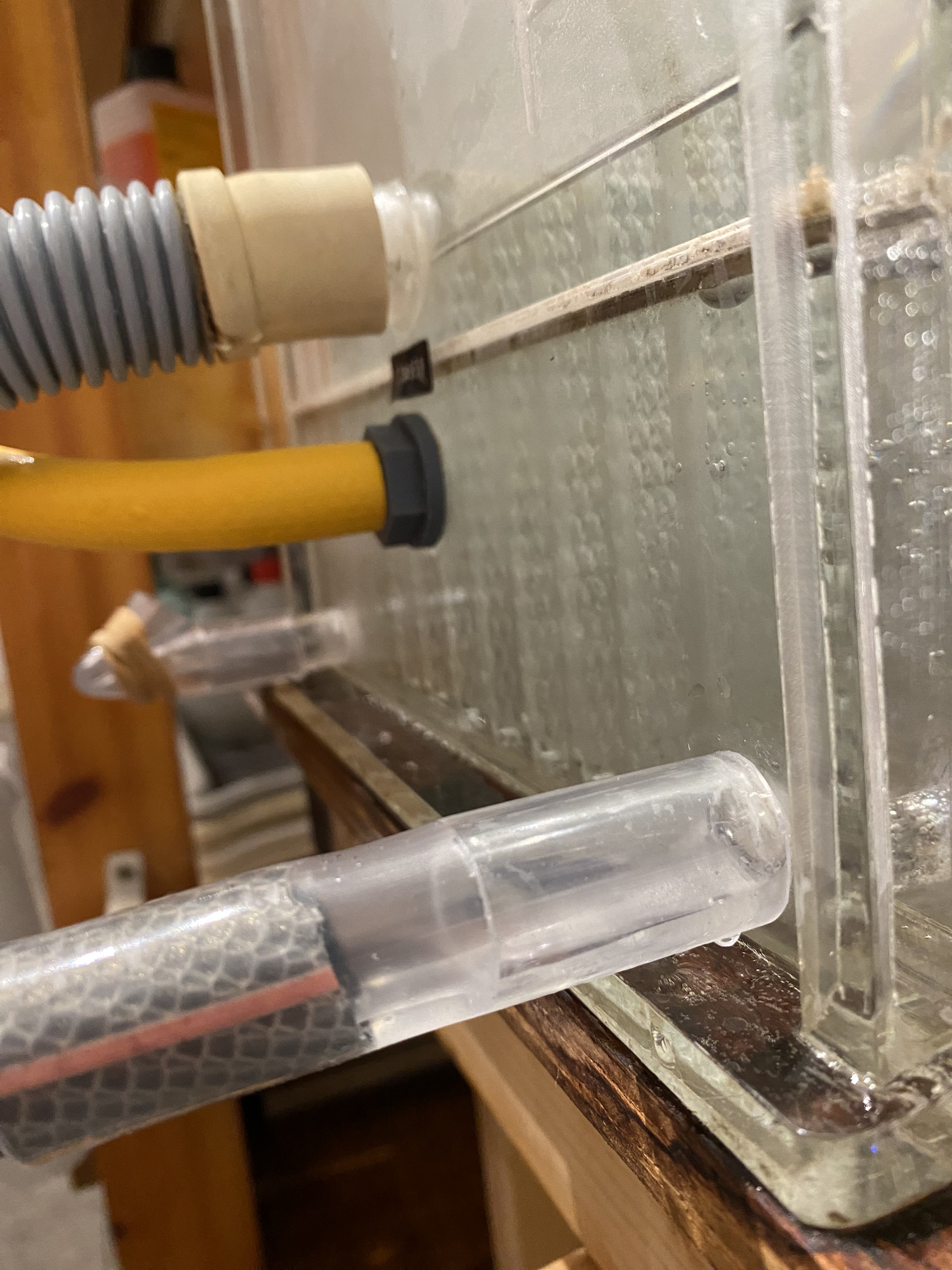

Imaging Warehouse support helped me this past week for alternatives to Acrifix, since they can't ship it here. Basically any cement made for use on acrylic will do.
For the spigots, I use similar ones that are available on this side of the pond, and are a bit bigger than the ones Nova supplies.

I would imagine that a spigot with a retaining nut and then silicone sealant would be a stronger arrangement. Is there room on the inside of your washer for such a configuration?
Doremus

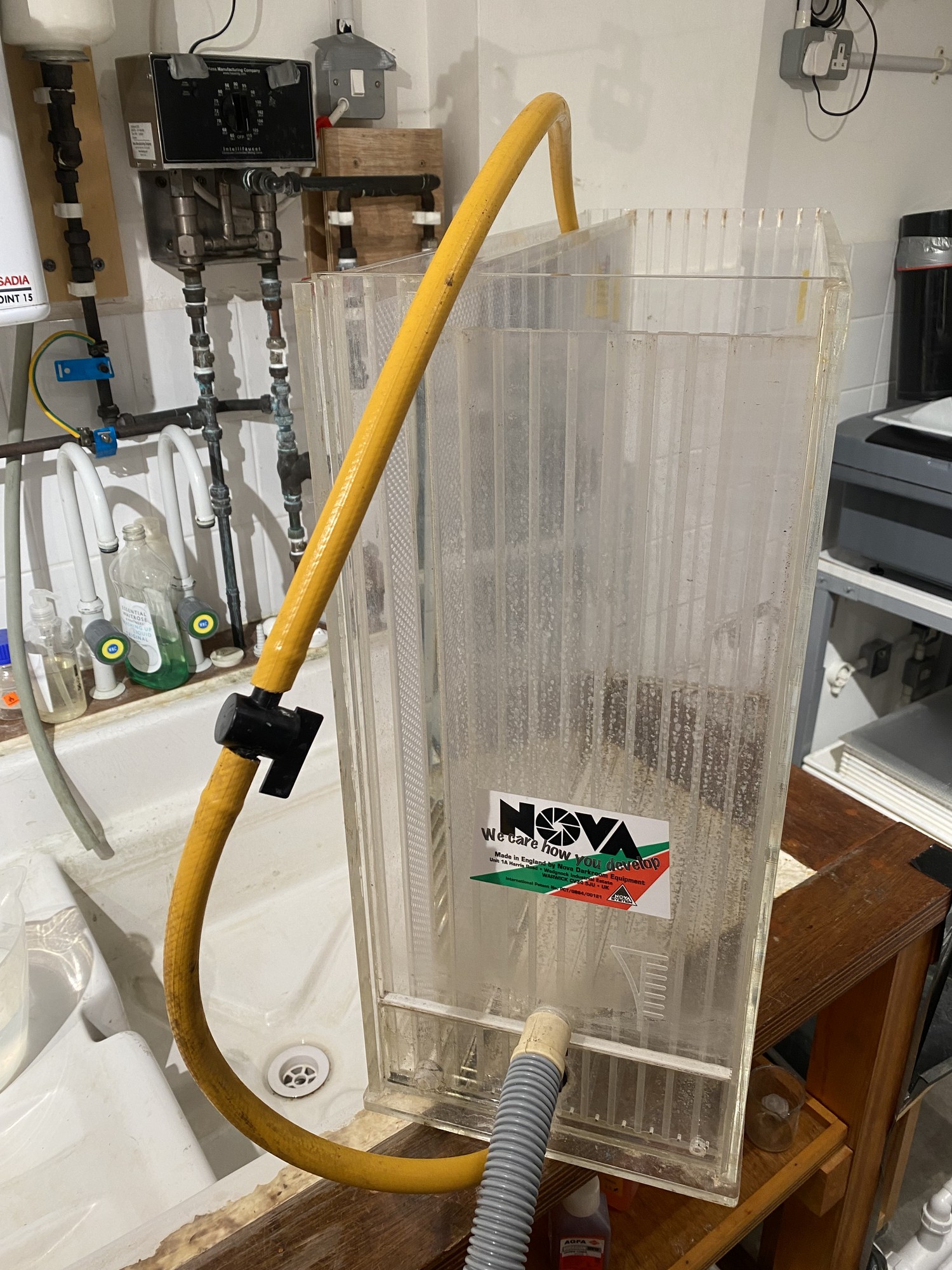

I have now had a chance to attach new spigots, which are working well. However I do need to order an additional tap as it turned out I only had one "in stock".
The acrylic solvent cement I linked to at the beginning of the thread seems to work well.
