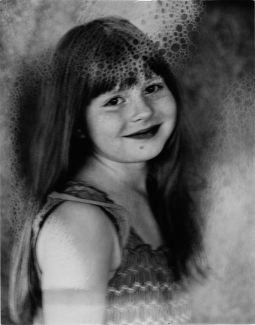

Shot eight sheets of 4x5 HP5+ yesterday and loaded them into a Jobo 3010 drum, which I have never used. Have a Besler motor based to turn the drum. I am looking for recommendations, suggest, and cautions about using this drum and motor base set up. And, I looking for good film and developer recommendations for this drum and motor base combination.

Thanks Kirk. I learned about uneven development from pouring without rolling the drum firsthand today...

Too bad your photo was ruined. It's a nice shot! That's definitely what happens when the drum is not spinning as the chemicals go it.
