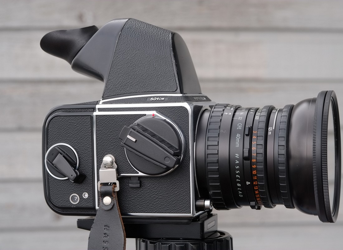

Well, it took a few years, but I finally bought a 40mm CFE lens. This one looks really clean, and the lens mount looks like it was rarely mounted to a body. I'll head off to Tacoma (Washington) to do some industrial photography. Next search: some color 93mm filters (yellow, orange, yellow-green).
