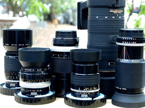

I use the following Nikon telephoto lenses for portraits on a 35mm camera (listed left to right in the photo):
105mm f/2.8 micro
85mm f/1.8
180mm f/2.8
105mm f/2.5
80-200mm f/2.8
75-150mm f/3.5 Series E
All are excellent portrait lenses. The optical differences between them are very subtle.
My personal favorite is the 105mm micro because in addition to portraits, it is also great for jewelry and close-ups of body parts.
The 85mm is great for half-length and head & shoulder shots.
The 180mm is great for headshots and face shots. For face shots, I must use an extension tube for close focusing.
The 105mm f/2.5 is great for head & shoulder shots and headshots.
The 80-200mm is the lens I choose when I shoot candid portraits of performers on stage.
The 75-150mm is my recommendation for a budget priced Nikon portrait lens.
