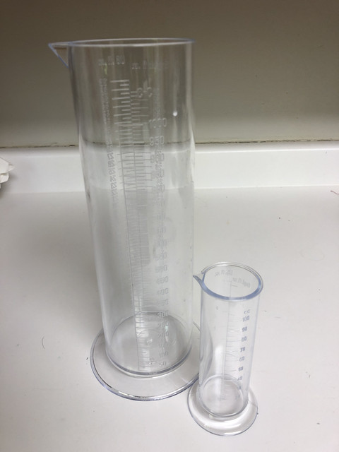

What I have. I've scrounged these up from Ebay. New prices exceed $30 us. These withstand anything I've used in my darkroom. These are OK for boiling water, never tried that

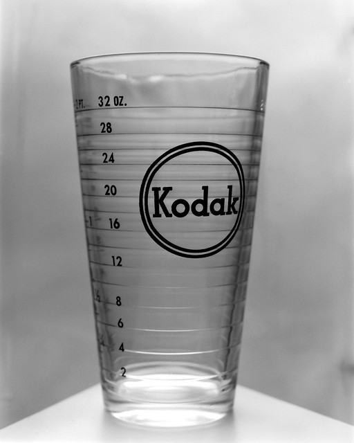

I just bought a 1L Pyrex beaker on Amazon for $18.80. The fear of breaking it has me worried but I thought it would work good with my magnetic mixer. The old Kodak glass is the best, I have the 32oz and 8oz. Tap Plastics is a great source for affordable graduated containers.
Vintage Kodak Glass Beaker by Bryan Chernick, on Flickr
