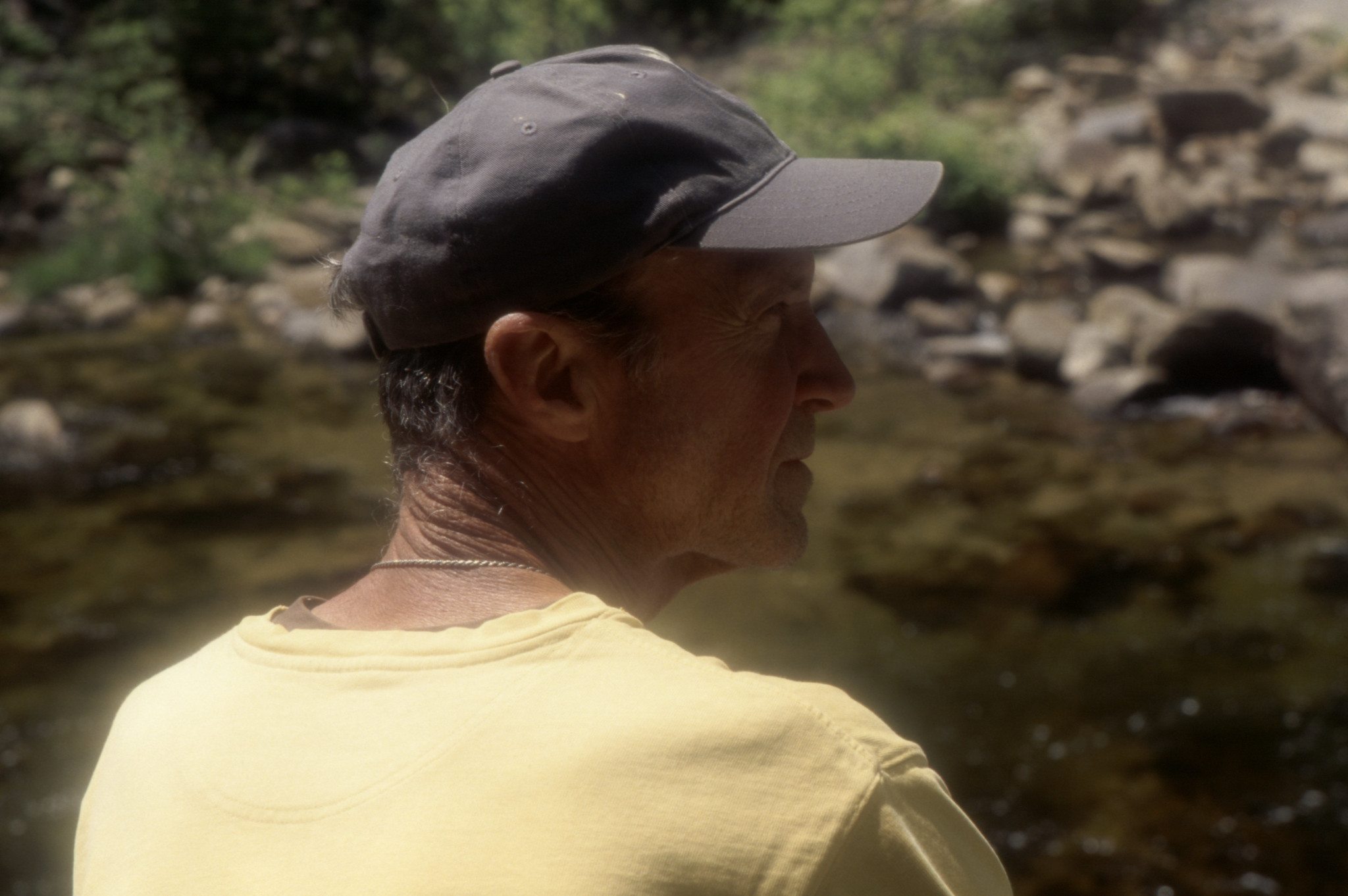

Not sure if this is the effect you're after, but this is a Jupiter-9 85mm f/2 lens with a front element that has hundreds of scratches. It has this glow on bright objects, even when you stop it down. I like it especially for portraits because of this rendering. The bonus is you usually pay less for such lenses. Ektachrome E100 shot.
There are also filters that have similar characteristics, I haven't tried them.
