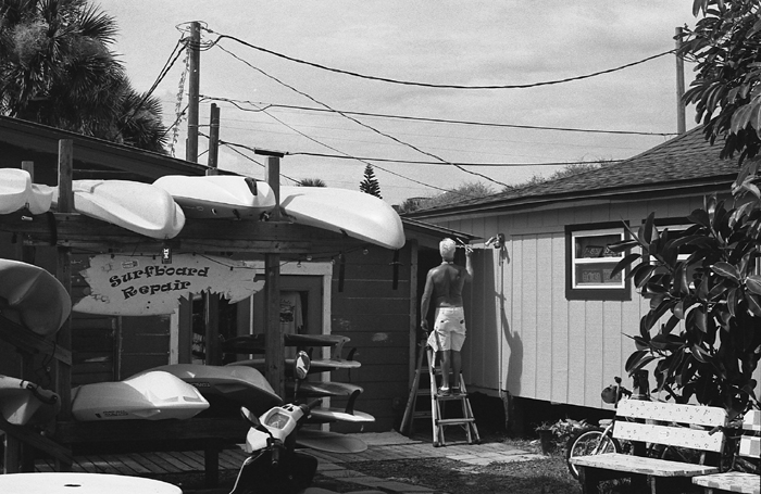

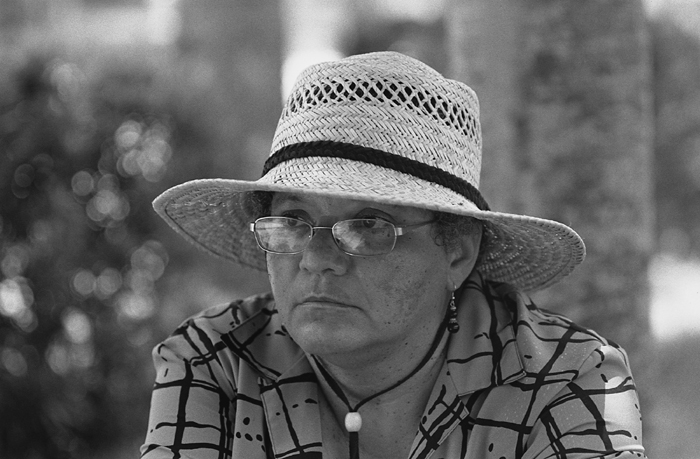

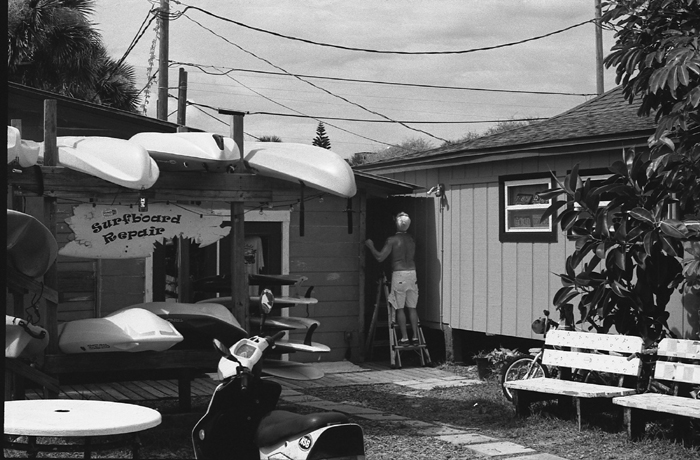

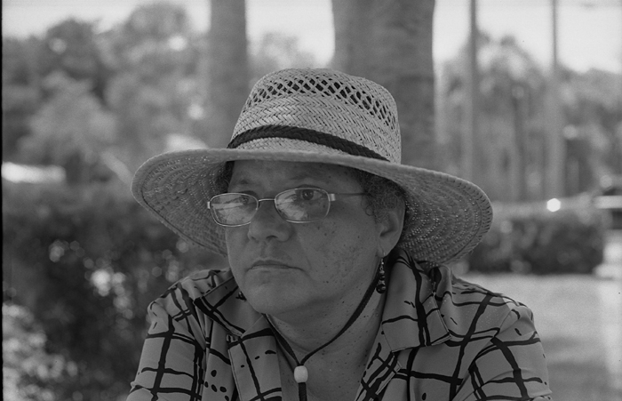

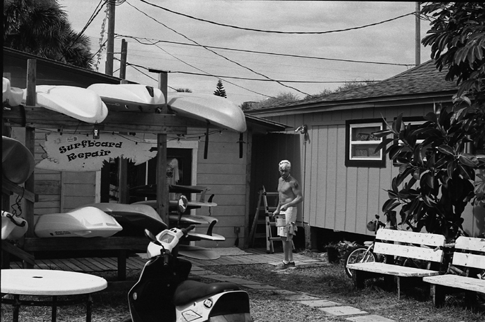

The following shots were w/ yellow, then orange, then red filters. You'll notice a big tonal difference in the stacked kayaks and building sides.
On the portrait, it was orange followed by red. Nikkormat FT2 w/ non ai 50 2.0 and Tri-X in D76. The light probably changed a little on the portraits, but the surfer that was painting was shot in constant light for all 3 shots.
