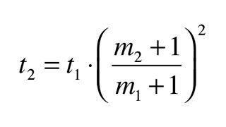

The inverse-square law to calculate old and new times (t1, t2) only works with the old and new paper-to-lens distance (u1, u2). For old and new magnifications (m1, m2), you need to use a different equation. See attached files.
