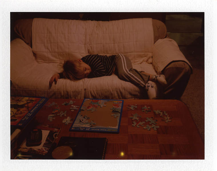

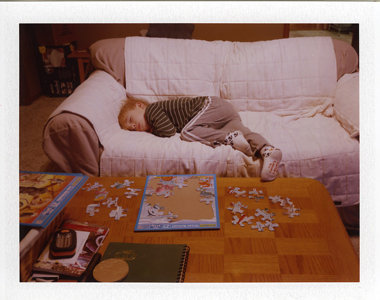

I shot these before I had Lee's chart. The darker one (done first) was at f16 for 20 seconds. The lighter one was f8 for 20 seconds.
