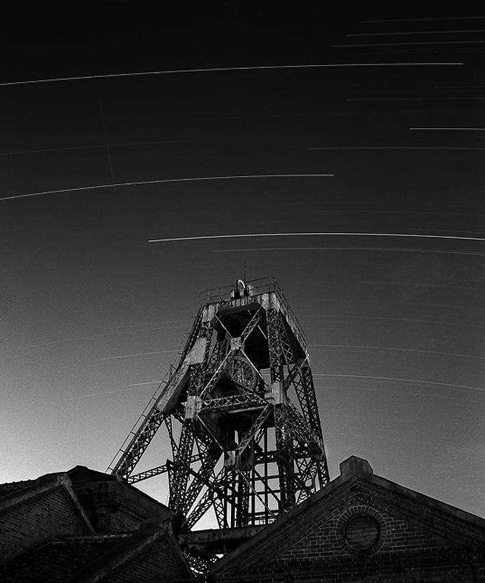

I light painted using the strobe effect with my flash when I was making my Stars Over Manda image. I painted so that the buildings would be more noticeable. The yagura (tower) was hit from close quarters. I had to climb a ladder to get close to it... The total exposure was about five hours. I spent around a half hour painting.. I didn't bother with reciprocity. It turned out well.
