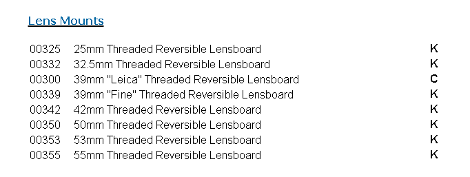

Isn't that actually an LPL 7451?
Aren't the boards reversible?
From KHB's page for the 7451 found here: http://www.khbphotografix.com/LPL/LPL4x5.htm
jejes
Sep 22, 2020
95
Canay Islands (Spain)
8x10 Format
MattKing
Apr 24, 2005
55,167
Delta, BC Canada
No problem with the switched around number.
Those flat lens boards appear to be non-standard for the LPL enlargers.
A peek at KHB's web store indicates that my 7700 enlarger and your 7451 enlarger use the same boards - here is that page:
http://store.khbphotografix.com/LPL-Lens-Mounts/
So you can expand any website searches to include the 7700 boards.
Here is an eBay listing from Germany that might help: https://www.cafr.ebay.ca/itm/167187...TlVeHfqqS+YeCKZcJ0ISotk7+b|tkp:Bk9SR7qIn-6DZQ
Is your 50mm lens one with a 39mm thread size?
