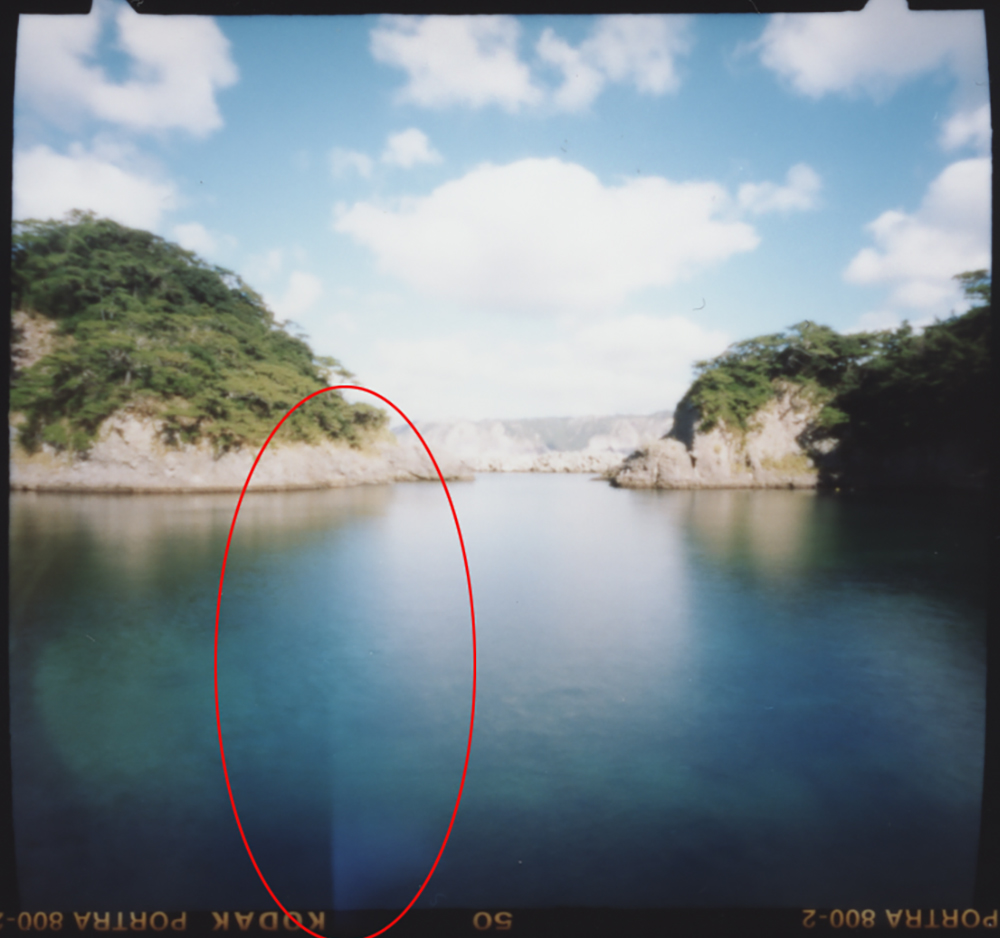

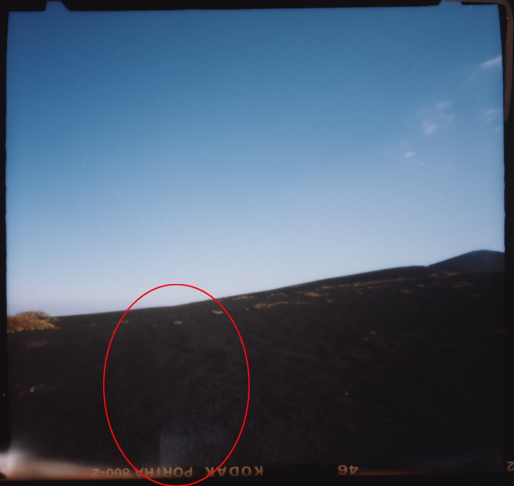

Hello,
I am having problems of Image Zero pinhole camera.
Irregularly the images get kind of leaking light like below attached images.
Does anyone know what it is and how to avoid it?
many thanks,

Zero Image cameras do not have any means to hold the roll under tension, so care must be exercised when loading the roll, and again when unloading, and definitely not in bright daylight which escalates the risk of spoilage.
Your roll is suffering from light piping, caused by loss of tension and slight unravelling as the roll is loaded and again unloaded into the camera. When this happens, light seeps through the spool ends (top and bottom) and causes the characteristic flare you are showing.

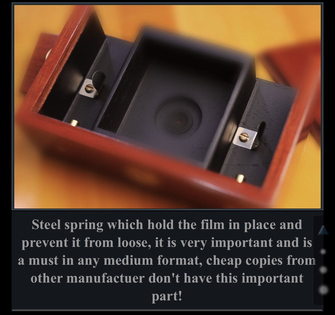

Zero Image cameras have built-in tension springs ; are you sure your problem is caused by a loosely wound spool?

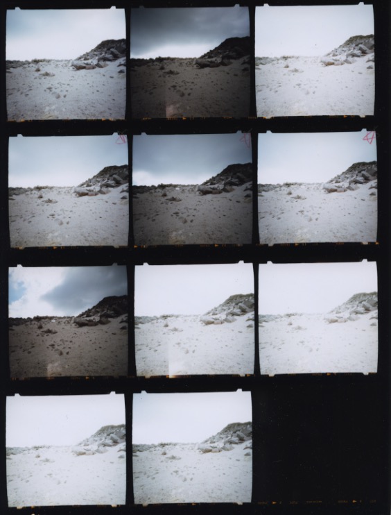

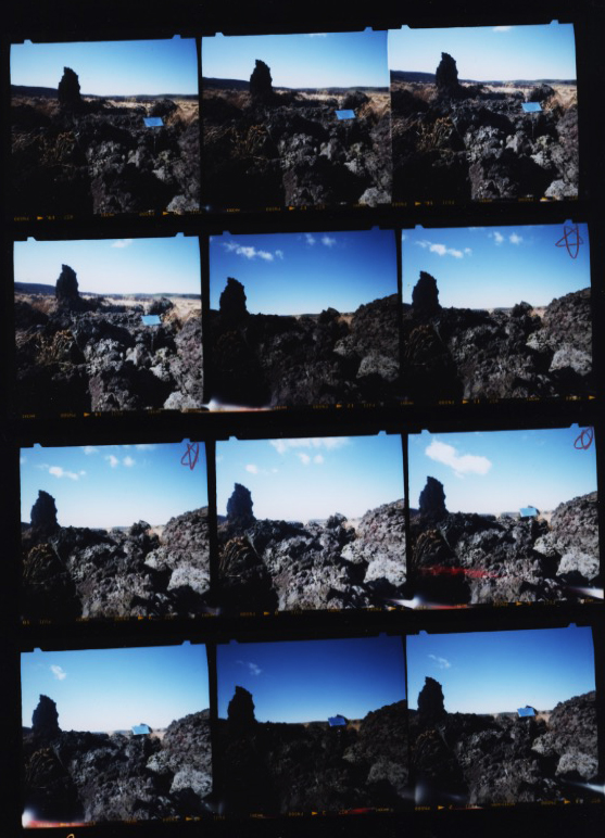

to illustrate:
