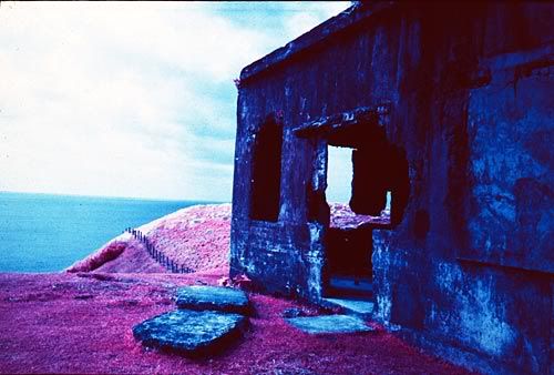

Hi

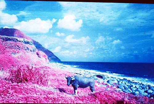

I've only had the chance to use Ektachrome IR once, and used a K2 (yellow filter for BW) with it since I didn't have the Wratten 12 or R72 filter then.
The film was already past its expiry date by about a year and was exposed at EI 200. It was used mostly under tropical sunlight. The resulting pictures didn't have any magenta cast in them, and came out looking like typical colour IR shots. The filter you used may not have caused the magenta cast-
but then again, IR photography is already tricky, and colour makes it even more. It's always subject to a lot of things- karma included :D
Like what you observed, foliage goes magenta and stone goes rather blue.
These shots were made with a Ukrainian FED-1 rangefinder, a 50mm lens, and a Russian Ж-2 (yellow#2) filter.

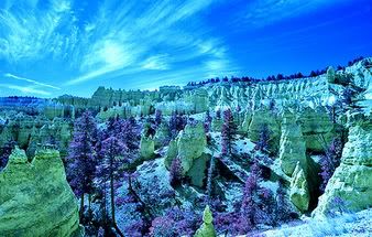

A couple examples:
with a yellow filter:
With an orange filter:

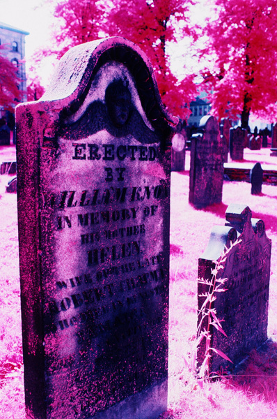

Okay, here's an example of one of the really magenta shots. I think it is just the amount of IR being reflected but I'm still curious if different filtration would affect this.

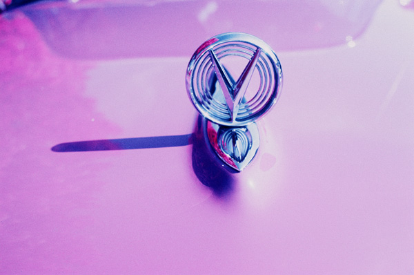

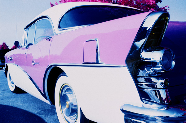

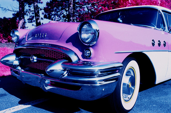

Here's the sequence of shots of the '55 Buick I mentioned, I'm really happy with the way these turned out.

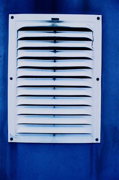

One more shot that I'm pretty happy with even though it's not the characteristic effect from EIR, I really like the coolness of this image.

Those colors look a lot like those of the rolls I processed in the unicolor kit. The reds should be darker, almost blood red for some plants and the color of the ground and rocks should be more neutral. I'd say you do have a bit of a problem with the processing, exactly what I can't say.

Given the subject matter, I think it looks just fine, i.e. it's not overly magenta. All a different filter will do is make it look a different color. A polarizer may have helped a little (I'm not sure as I've never really tried one with this film) or else maybe try the shot again when it's overcast. The moss on the stone isn't helping you to get that cool blue you are looking for. Yes, there is a lot of IR being reflected by the grass and the moss in this shot.

Thanks for the advice, I think it was the conditions. I picked a really hot bright sunny day thinking that would help get the IR effect but maybe I overdid it. Obviously the photo of the grate is so blue because there's nothing really reflecting IR in that shot, but I like the effect.
