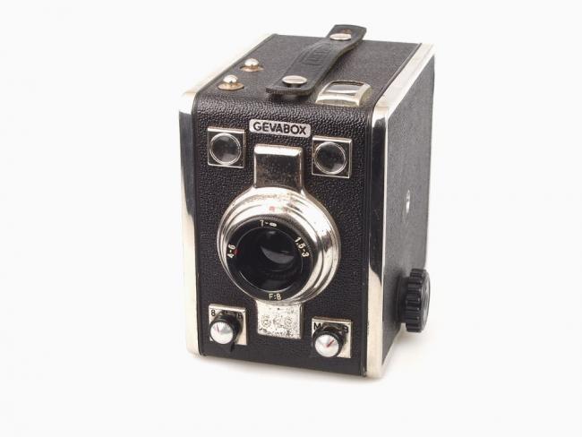

I have converted an old Agfa Clack and an old Gevabox into a pinhole camera.
They're great to use and very suitable for portraits too.
attachment.php
attachment.php
If you don't have one of these, I can send you an Agfa Clack if you like, so you can convert it yourself (not difficult to do).
