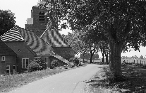

This Ortho film is preforming 330ln/mm so a lot of things are depending on your lens.
The film can be exposed as E.I. 25 and developed in a low contrast developer. RLC or Rodinal 1+50 (100) are both good suggestions. RLC keeps the logD curve less steep.
Here an example (Leica glass):
