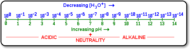

Kodak Indicator Stop is perfect for "eyes on" determination of effectiveness. As stated earlier, it changes from yellow to purple as it becomes exhausted. Stop is nothing more that acetic acid. Film developers are generally alkaline in nature, and the addition of a dilute acid base such as acetic produces an environment that arrests the ability of the developer to act on the film. A working solution of stop bath should have a pH of less than 7 to be most effective. 7 is considered "neutral" as shown in the chart below. Below 6 is recommended, discarding when the pH reaches this point. A small tester or strips are a great way to determine this, as well as the alkalinity of your developer. Testing the alkalinity from a fresh working solution to one that is reused is a good way to determine its rate of exhaustion. There are some developers that it is a good idea to monitor as development occurs so that adjustments to time can be made.
