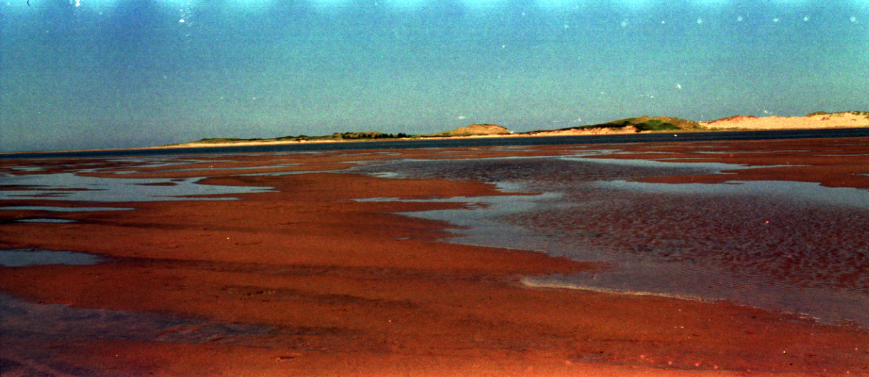

When re-bleaching C-41 Negatives do you wash the negatives first, to rinse off the Stabilizer & Photo-Flo
& reuse the Bleach & Fixer?
Another question would be how long should the chemicals sit before processing? once you mixed Liquid Chemicals.
I am leaving the stock solutions in the Fridge at 45 degrees due to the immense summer heat presently & the low volume I am processing.
Mixing with water at 120 degrees, the chemicals are around 90 degrees when mixed & heat up the rest of
the way to 100 degrees in the Processor.
The Processor is level & receiving 200 ml of Chemical for 1 Roll of Film. The minimum for 1 Roll is 110 ml.
A test strip of film (4 exposures) came out perfectly, then a 24 exposure film resulted in the scan below with fresh chemicals.
The negative is directly scanned with no Photoshop adjustments.
I'm baffled.
Thanks
