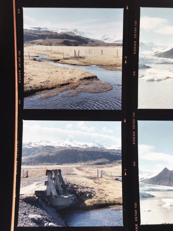

Last night I printed a few contact sheets from Ektar 100 negatives processed about 18 months ago (they have sat untouched due to a house move). The images are very unsaturated and not 'Ektar' like at all. I scanned a couple and they look rather 'muddy' and desaturated. Deep blue skies are lighter than expected and tending towards cyan. My guess is the bleach wasn't run to completion for some reason.
FYI the film, C41 chemicals, RA4 chemicals and colour paper were/are all fresh. The C41 development was standard Kodak routine at 100F in a Jobo. The Fuji Crystal Archive paper was processed with Kodak RA4 chemicals at 35C in a Nova tank.
To give a sense of what the sheet looks like in real life, I'd estimate the attached photo has 50% more saturation than the print.
So, my questions:
1. Could there be any other explanation?
2. Is it worth running the bleach and fix again, even though the negatives are 18+ months old?
3. Can I run the bleach and fix in trays in daylight? (they are cut strips, so awkward to load back onto reels). If not, how about a combined blix?
Thanks

Here's a better image. I've desaturated my iPhone snap to closely match the print:

Looks normal to me; but I’m not very good at judging pictures. It might be worth a try to re- bleach and fix the negatives, but I think the desaturation is because of the Fuji paper. Some people have said that Ektar prints pretty badly on Fuji ca, and the paper isn’t very saturated.
Thanks for the input, but these are definitely not 'normal' for Ektar printed on Crystal Archive. I've also read a few comments about Kodak film + Fuji paper, but I've printed a fair few using this combination before and the saturation is always much higher than this.
Any idea about question 3?

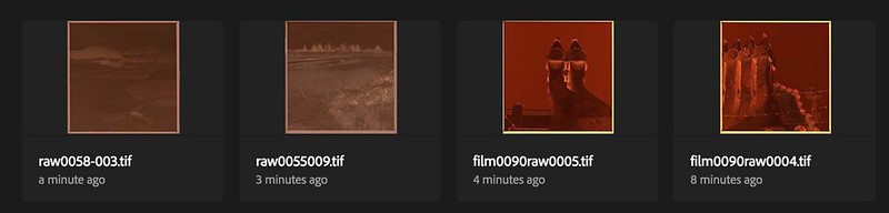

Here's what the linear scans look like (first two), compared to a roll of Portra 400 that look normal to me.

When were negatives 3 and 4 processed and were they processed in the same make of chemicals as the first two? I had always thought that Kodak C41 chemicals had separate bleach and fix. Is this the case here? RA4 has blix as standard anyhow but there are those who believe that blix in C41 has risks unless it is very fresh but if you stuff was C41 blix then even PE, our Kodak engineer, admits if I recall correctly that blix is OK if completely fresh. I am not sure how many times C41 blix can be used before he believes that its efficacy may be compromised. If of course it was separate C41 bleach and fix and was fresh then it would seem that further "dunking " will not achieve any improvement.
Have you prints from Kodak RA4 chemicals taken on Ektar but processed on Kodak paper to compare? The scenes are not the same but have you got contact prints from negs 3 and 4 processed in the same RA4 chemicals as your contact you have shown us?
There is a lot of variables here and we will all come up with solutions but until we can narrow down causes we may not get anywhere

I processed the dodgy negatives myself using Rollei/digibase C41 chemicals with separate bleach and fix. The other negatives shown above were processed by a commercial shop. Having said that, I’ve not had this issue before using the Rollei chemicals. I think I may just have forgotten to aerate the bleach and not run it long enough.
Unfortunately I only have Ektar negatives printed on Fuji paper...but they look fine regarding saturation and contrast.

I think your second para in #7 rules out Fuji paper as the cause. The same type of film processed by you in one instance and commercial lab in the other suggests to me that either the Digibase chemicals were faulty or as you have said the bleach stage was too short and/or not aerated enough
I will rely on others to say if fresh bleach now can do anything once the negs have been fixed. For what it is worth there was a long thread on Digibase some years ago and the conclusions was that the Digibase instructions on the bleach time was way too short. I wrote down what the consensus was on bleach time and it was 6 mins 30 secs with a 4x 30 secs wash followed by a 6mins 30 secs fix.
The whole process was almost 24 mins which does seem a long time but presumably results in a real "belt and braces" process.
