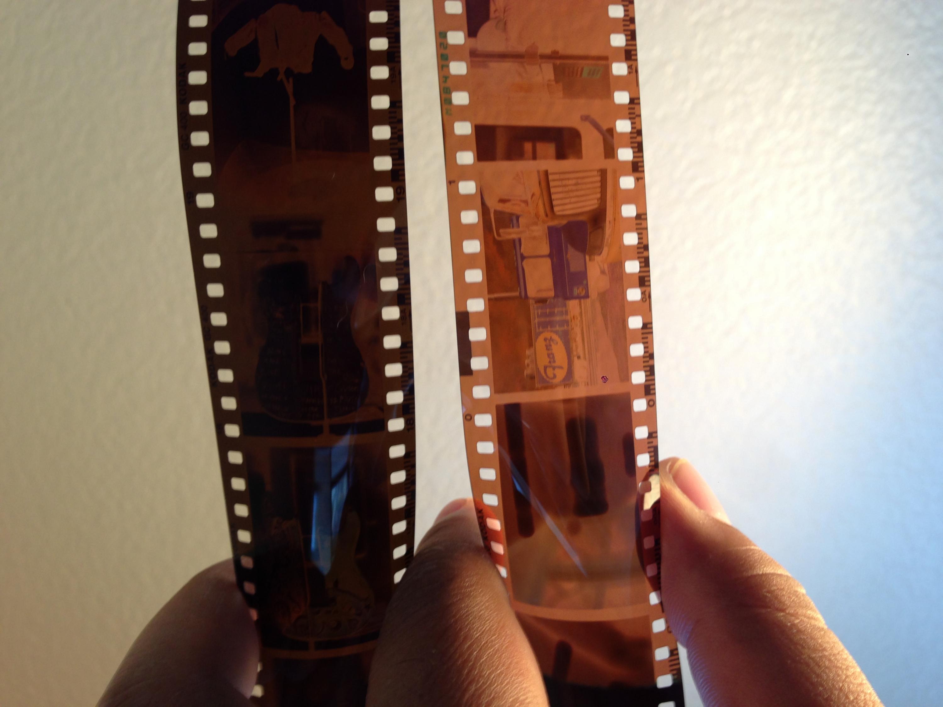

You were right... I tried re-bleaching the film and it didn't do much of anything. Again, I use the Flexicolor SM chemistry—the bleach and fix are separate. Could you tell me more about why it had no effect, and what I can do to prevent this from happening again in the future?
(For reference, here's what I'm dealing with. My hand-processed film is on the left, and the lab-processed film is on the right. Both are Ultramax 400.)

after bleaching you would have to fix, wash and stabilize. (whatever the final rinse is called in your kit.) just bleaching would likely not change the density much.

From your description I thought at first it was a retained silver problem with your bleach (ie: not bleached enough or reusing bleach with out proper rep), but on seeing you shot of the negs I think your problem lies elsewhere. Could you have over developed it? Was the dev temp correct?
I don't have any experience with home kits but have 34 years experience with pro C41 processing. Standard machine C41 is dev 3' 15" @38C +/- 0.1C. The rest of the chemistery has a +/- 2C, you might even get away with more but I never tried it.
I have an older mercury thermometer that I calibrated using ice water. I'm fairly sure I kept it at 100°f for 3'15". I do know that I'm a pretty slow getting the developer in and out of the tank, so I may have overdeveloped them. I couldn't have done it for any more than 5 seconds, though. Would that cause such a dark film base?

If you rebleached without fixing you should definitely see a difference - in that you shouldn't even see the darkness anymore. However, you NEED to fix or that rehalogenated could technically print out since its now "live" again.
If you saw no difference with your bleaching, and your negs sure look to me like they have silver in them, then your bleach is toast. Bleaching should make the visible silver go nearly invisible. Redeving will bring the silver back to the metallic state OR fixing will remove it permanently.
I'd make it a priority to figure out what's going on as if the silver is in the rehalogenated state without being fixed that's a bad thing. There's no risk though if your bleach is toast because its still metallic silver.
That being said it seems pretty unlikely your flexicolor bleach just decided to stop working, especially considering it's not a blix.

If the bleach given to you was bunk, do not fret. This only means you effectively did a 100% bleach bypass or skip-bleach on those negs.
At any point, you can rebleach and fix to remove the silver. As it is now, the silver is in a metallic fixed state, and you're at no risk of printing out.
Ferricyanide bleach is easily made with raw potassium ferricyanide powder (completely safe) and potassium bromide. Both available from Artcraft chemicals cheaply. Alternatively you can buy a smaller quantity already mixed up. Use a small amount of concentrate with water you have your working bleach. The concentrate lasts a very long time, the powder forms pretty much indefinitely.
The entire purpose of bleach is to rehalogenate metallic silver back into silver halide. This means it becomes light sensitive, redevelopable, *and* removable via fixer if not redeveloped. It doesn't matter if you bleach in full light, because the image forming silver is all that is left at this point (since you already fixed before-hand).
