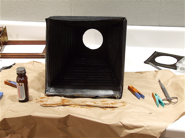

I usually attach bellows with contact adhesive.

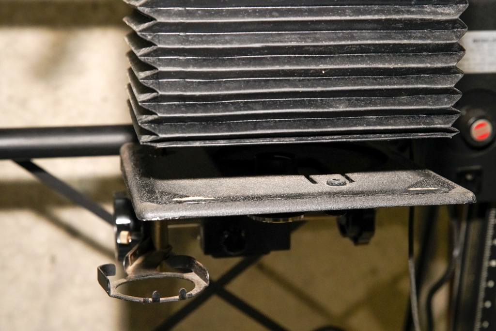

I have two Beseler 23CII enlargers and made this repair using 3M 1/2" wide, double-sided adhesive Auto molding tape (label says "3M Auto/Advanced Super Strengh Molding Tape). You can get it where auto supplies are sold. Just cut to size, place on the lower lens stage, then press the bellows down along the perimeter and attach it. This has held up now for about 12 years so far. No light leaks. No mess.

Great suggestion. I also have a 45MXT. Both ends of the bellows came loose. Used two rolls of practically the same tape (1/4" wide 3M Auto Exterior Attachment Tape 38582) after cleaning the metal surfaces. Still solid after 6 months. No fuss, no mess. Hopefully I can get 12 years out of it also.
