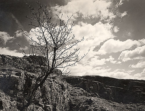

I've only used the Ilford Warmtone developer on Kentmere Kentona so far, so can't really comment on other papers but MGIV is somewhat famous (notorious? :wink: ) for resisting tonal change in most developers and single-bath toners (such as selenium or gold).
I would have expected some shift in MGIV Warmtone however. Chocolate without toning is perhaps being a bit hopeful though.
The attachment is a work print on Kentona (will need a lower contrast paper with this negative so I gave up on this combination) but hopefully shows the tone possible with Ilford Warmtone on this paper.
Cheers, Bob.

Hi Bob, that was the type of tone I was looking for. Did you process in selenium after printing?

Nope: Kentona is well known for its colour shift ability (hence the name) so I'm not too surprised it changed tone so much but I would not really expect MGIV of any type to do the same. You could try diluting the Ilford developer more - that tends to give warmer tones with most developers - it did work somewhat with Neutol WA when I tried it. It does increase development times though.
The downside of the Kentona is that it is only available in Grade 2 so you have to be a lot more careful with adjusting development times to make the negative fit the paper for different subject lighting conditions - more careful than I tend to be...
