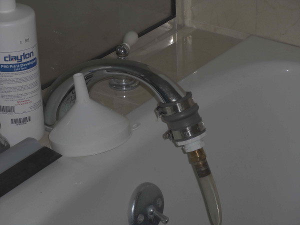

I got some plastic and rubber adapters that fit a Kodak siphon to the bathtub faucet.

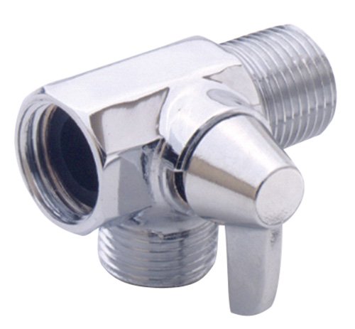

I pulled off the shower head, put a diverter on the pipe, and put the head on it. The diverter looks something like this:
https://images-na.ssl-images-amazon.com/images/I/41DzBLhxbJL.jpg
I attach a hose to it when developing, which connects to the hose on my film washer. I turn the diverter to the appropriate outlet, then turn the shower on. I have another hose for when I'm washing wine carboys.
My setup is a bit more complicated than I have stated, because the shower head also has another detachable head, but you get the idea. I also added an elbow so the outlet points towards the tub instead of the wall - which is very useful if I forget to change the valve back to the shower head.
