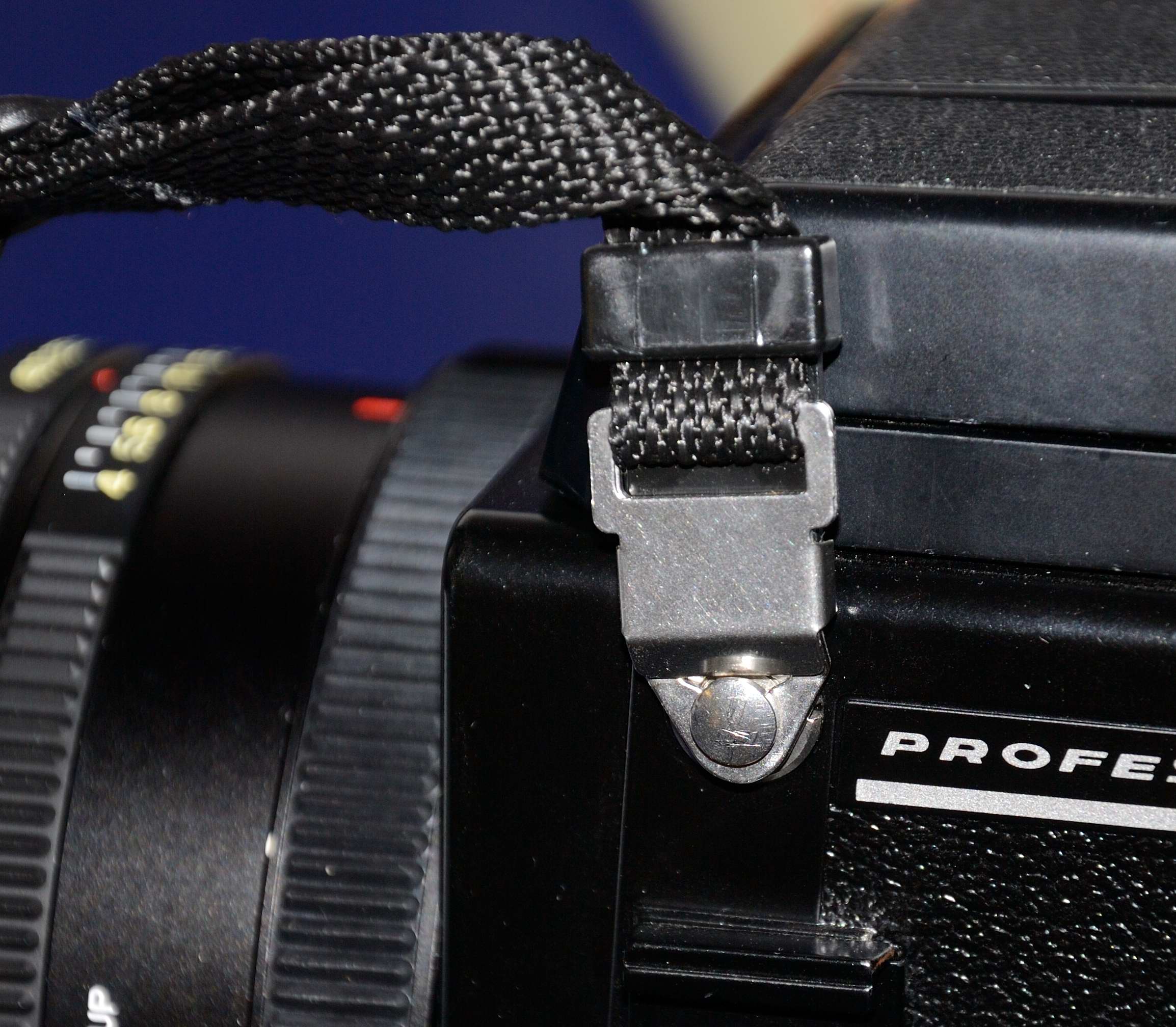

Well.... since the camera itself wasn't really designed to be a portable system, it will be kind of weird. Let me take a photo of mine since I have the same camera and the strap.
tkamiya
Oct 3, 2009
4,284
Central Flor
Here... does this help?

Yep, you got urs up...
...camera itself wasn't really designed to be a portable system, it will be kind of weird.
yeah.. but it is such a well engineered camera, love it, yet... there's got to be a better way to carry it, perhaps in a camera bag over the shoulder, and just set up the strap as a 'handle' to pull it out and carry it, and then shoot with it on a tripod or hand held.
Was wishing to sling it on the shoulder, but with the strap up.. its to awkward.
