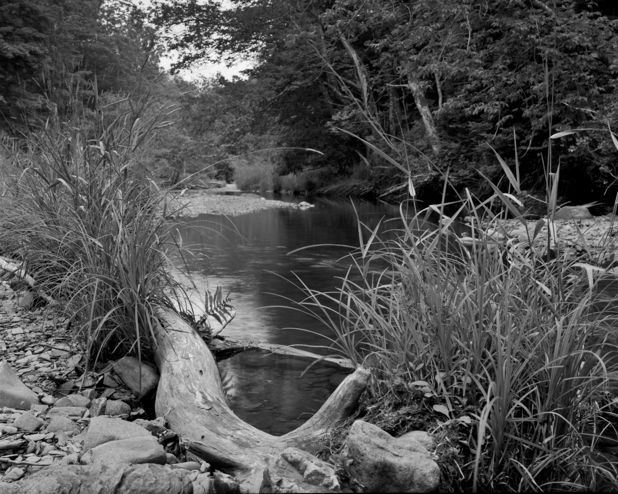

hello everyone,
I have an RB67 ProSD with 90mm KL and 180mm KL lenses. Both lenses are great, but I would love to get a wide angle for shots which require greater DoF. Right now the 90mm is not doing it for me - in order to get close foreground objects in focus I have to give up focus at infinity (see attached picture for an example).
I am unsure whether to get the 65mm KL, or get a C or non-C 50mm. I would like to hear people's experiences with these lenses, or any examples of pictures taken with them. Really any input you can give would be helpful. Thanks!

Great photo. I just bought the 65 but haven't used with film just yet. I will say though that the min focus distance is amazing and I look forward to the opportunities it will provide. I don't recall whether same thing with 50mm, but may be a factor for you; maybe not. Look forward to your result!

I also had 180mm and 90mm lenses and was looking for a wide angle. I choose the 65mm because of the significant distortion of the 50mm. If you are planning on using it primarily in the landscape this might not be an issue, and the 50mm would give you greater depth of field for shots like the one you posted.
Either way I would not get a Non-C wide angle lens as they are only single coated and wide angles are more prone to flare and more difficult to shade properly.

Get the 50mm lens, you will never regret it. That lens can hyper focus from a few inches to infinity with less distortion than most wide lenses and has a look unique all it's own.
The beauty of the RB is that is has can focus so close with any lens, the bellows is over extended by 43mm as it is.

I have (perhaps) bad news for you: DOF depends on optical magnification, not focal length. If you use a wider lens and get up closer to the "subject" so that it's the same size in the frame, the DOF will be the same as if you'd used a longer lens from further back. The background blurs will look smaller but the truly sharp region of the frame will be the same. So if you like the dramatic in-your-face wide perspective, you're not going to fix DOF problems by going wider.
Of course if you keep the same camera position (subject/camera distance), the DOF will be greater on the shorter lens because the magnification is lower and for a near-infinity scene (at or near hyperfocus) you obviously get more DOF from the wider lens.

I understand exactly how depth of field works, so there is no bad news. I was speaking of needing greater DoF in shots like the one I posted. In practical terms using hyperfocal focusing, the 50mm at F32 can focus from a little over 1.5 feet to infinity, whereas the 90mm at F32 is a little over 5 feet to infinity.
