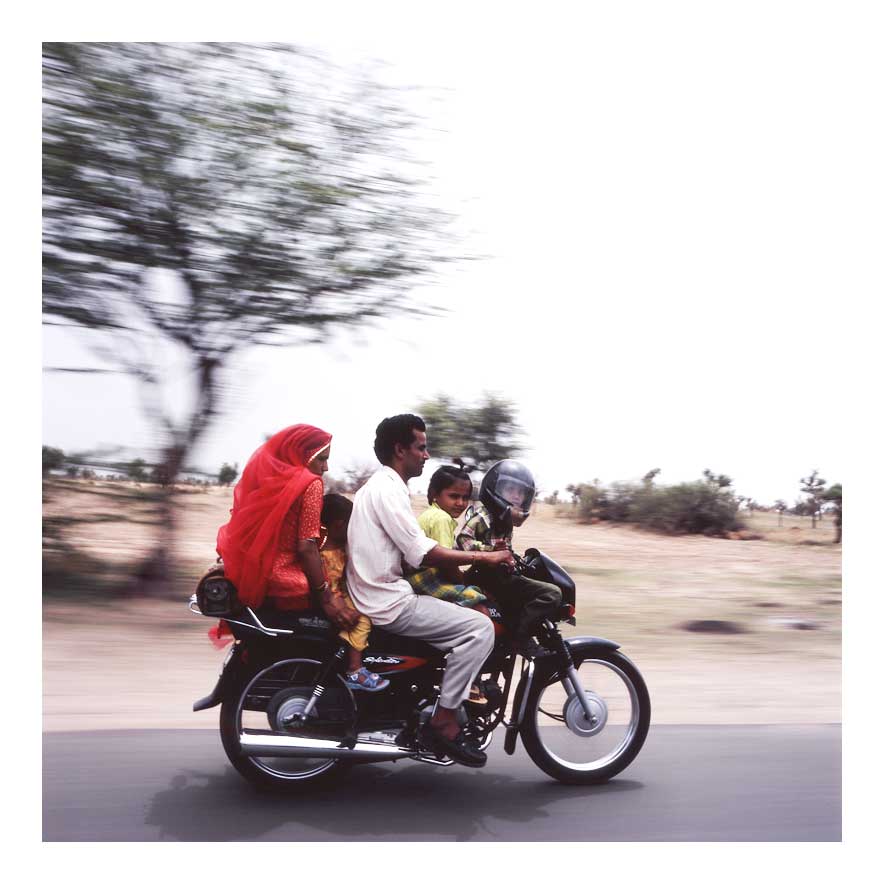

This was made from the passenger seat of a car I was travelling in in India. I used a Hassselblad with a 50mm wide angle lens Because of the waistlever finder, I could not compose the image (I could not get the camera low enough to look through the viewfinder, and neither could I rise enough in the cabin of the car to look through it). I told the driver to keep driving next to the motorcycle, I pointed the camera out of the window and used the hyperfocal setting of f/16 or f/22. I made a few exposures but only this one was to my liking.
I really, really like that picture - but I must say; why didn't you just flip the camera upside down and look up into the viewfinder? :smile:

"but I must say; why didn't you just flip the camera upside down and look up into the viewfinder"
Or sideways with the viewfinder facing you, it's 6x6 format it is not going to affect the composition.

Thanks for the compliments. Sideways would have been possible come to think of it, but at the time, I didn't. Upside down was not possible. It was an Indian made Ambassador car, a replica of a 1950's Morris. It is a comfortable car but since I am 2.03 meters tall, the cabin is a bit small for me.
