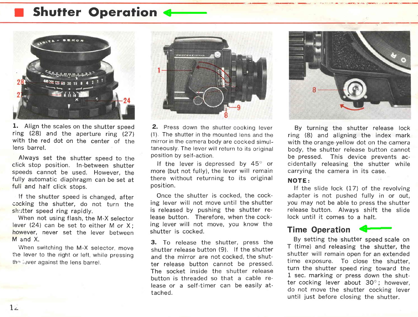

Bronica, which used Seiko electronic shutters, had a T setting on its lenses so that continuous battery consumption (during B) could be avoided on very long exposures.
I cannot say what the reason would be in a purely mechanically timed shutter though. Dan Quall's explanaiton of T for 'open to focus' on large format cameras makes sense, though. But Alan Klein's included instructions make that particular example (large format focusing) not really terrific implementation.
Alan Edward Klein
Aug 29, 2017
10,175
New Jersey formerly NYC
T shutter operation from RB67 manual

'T' shutter works thusly:
  1. Cock shutter
  2. Fire shutter to open
  3. Fire shutter to close
That is the technical description of how a T shutter works.
Unfortunately, Mamiya RB 67 instructions state otherwise...
"2. To close the shutter, turn the shutter speed ring towards the 1 sec. mark, or press down the shutter cocking lever about 30 degrees"
It goes contrary to what you or I had learned about the use of 'T' on a camera.
Then someone has to tell Mamiya that they do not know how to follow industry standards.

They are the industry standard - for bellows mounted interchangeable lens 6x7 SLRs.

I would place the real blame on Seiko, the shutter manufactrer. Even on the later electronically controlled Seiko lens shutters, T was terminated by sliding the T control, not by depressing the shutter button again...and similar operation was on Bronica's Seiko electronic shutter.
