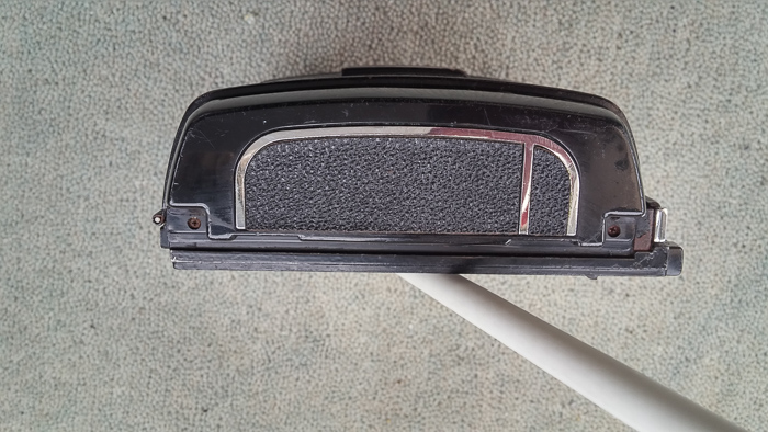

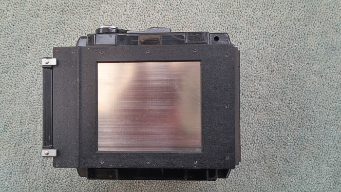

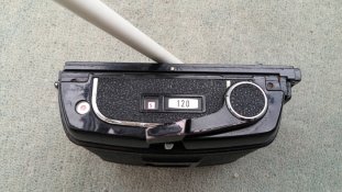

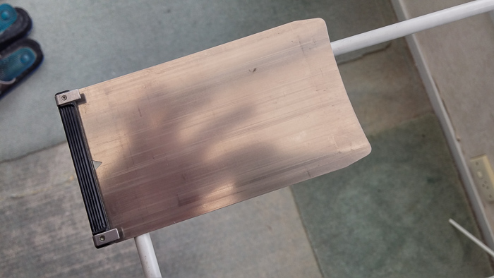

take a look at the revolving back... does it have one or two chrome tits?
look at the film back... does it have one hole at each top corner? is there a small lever under the advance lever?
with the generic rb backs, you had to flick a small tab in the top center to be able to advance the film n shoot the next frame.
if you are unsure, post a few pix of the components you have?
ill have to pull out my rb n see whats going on with that darkslide problem. it may be possible your rev back is for the pro.
oh does your dark slide have a small notch in it by the finger grip?
btw never snap advance the lever. the stop for the lever is a cast metal part that can crack off if you use it like a 35mm camera.
and yes, there is a delay from when you hear tue mirror go up and the shutter goes off. set tue speed to a sec n tou will hear exactly when the shutter fires. so fire, mirror goes up, the shutter fires. hold your breath after you hear tue mirror.
flavio81
Oct 24, 2014
5,241
Lima, Peru
I always repeat on this forum to new owners of the RB series: "you MUST read the user manual!"
That camera needs servicing to make sure the interlocks work correctly. Never force anything on a camera. My mamiya works just fine with a gentle touch, no need to force anything.
You should never attempt to remove the lens without cocking the camera first.
rayonline_nz
Mar 20, 2010
658
Wellington,
Not sure what you mean but two chrome tits.
The film back. Yes I have to flick the tab before I can advance the lever. I had to do this when I used it last time.
The dark slide. If you mean a small triangle hole. Yes it has this.
