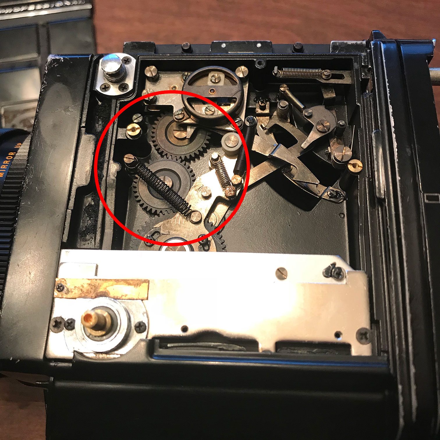

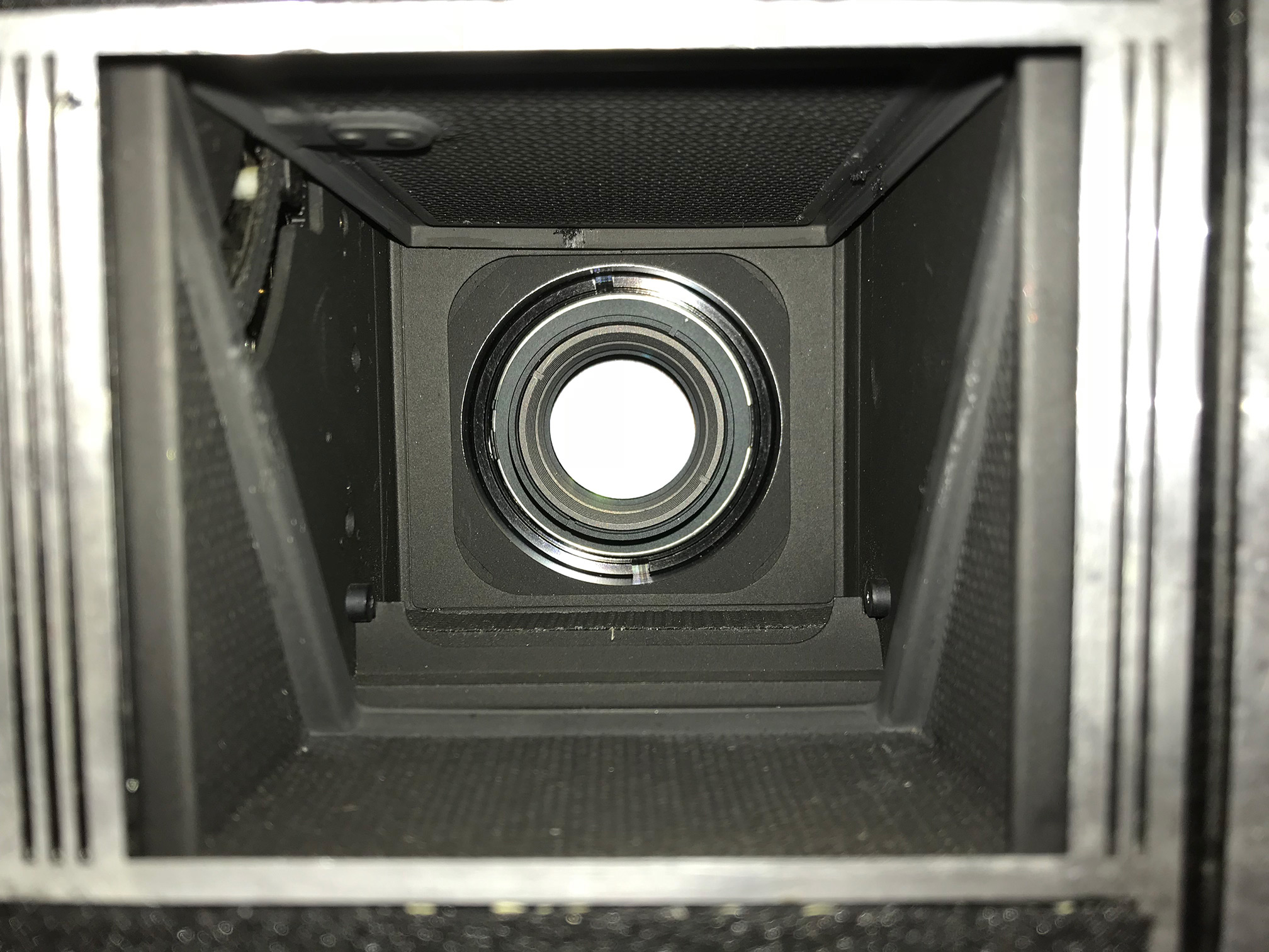

My RB67 is having problems firing. I attached a few pictures to show, but it looks like the light baffle isn't fully clearing out of the way? The shutter will fire once it does. Any ideas on what I need to do? This happens on all three of the lenses I own, but randomly. Thanks in advance.

Does the light baffle always go fully to the top?
Are the lenses in the mirror-up state by any chance?

The majority of the time it will go fully to the top and the lens will fire, but when it doesn't go up fully the lens won't fire. I have tested both mirror up and not and it happens in both cases. When I'm actually shooting, I usually have it in mirror up and when this happens I can't press in the cable release. Sometimes it'll take a second or two for me to be able to release it or I'll have to jiggle the shutter lever a bit and it will work.

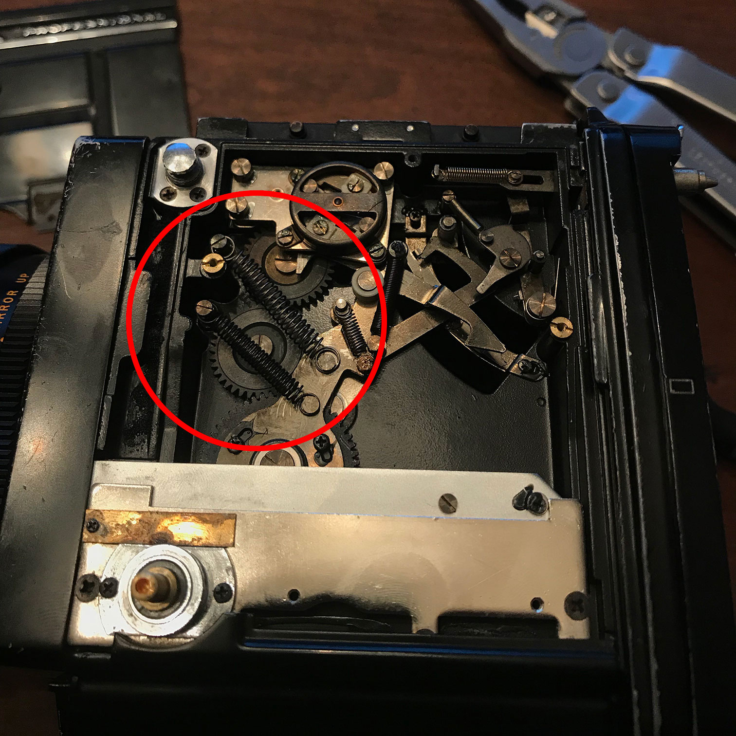

For those interested I think I found out the problem. I opened up the camera and noticed one of the springs was missing (not sure how that happened), so there was only one spring pulling that lever back up. I replaced the missing one and it seems to operate normally now.

Well done. How easy/difficult was it to open this side of the camera? Specifically removing the leatherette from the focus knob, and removing the side wall/plate? I have a spare Pro S body that needs some adjusting on this side of the body and want to do it at some point.

It was very simple, and I knew/know very little about fixing these. I just used the service instructions book for reference, and read a few forums on the topic beforehand.
