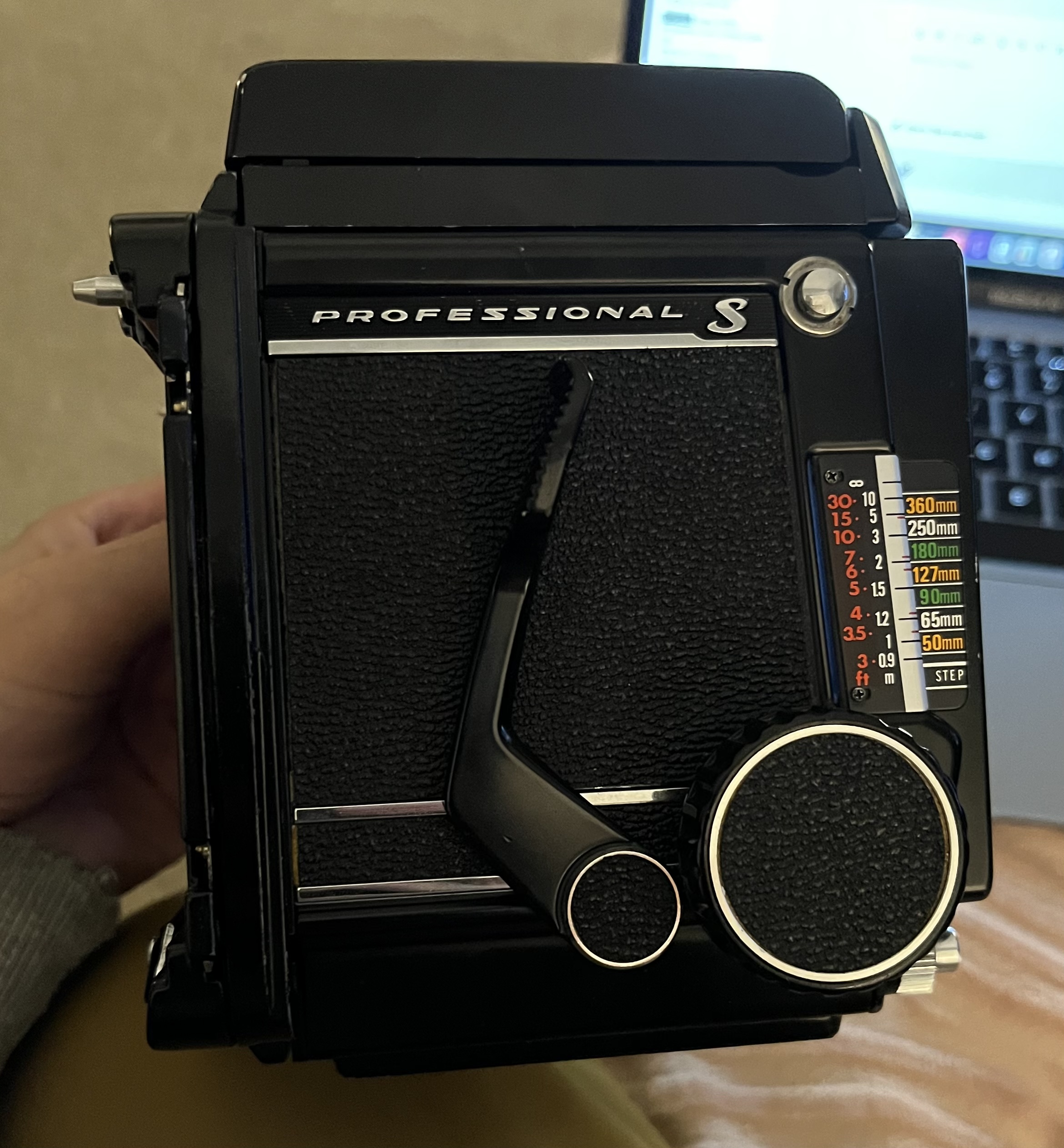

Took my RB on a hike today. The shutter lever wouldn’t move so, checked everything and it was as normal, so with great difficulty I managed to get the lens off. I’ve taken off everything and it won’t advance and I’m totally stuck. Any help would be welcome.

Are you referring to the cocking lever?
With my RB67, that used to be a sign that I hadn't finished the cocking stroke - usually because something like the neck strap was impeding the final short bit of its travel.

The cocking lever is sat completely upright, never had a problem with it. I only had it serviced in feb.

Will not budge

Can you try it with another lens and back?

I've tried it with both lenses and what's happened both times is the lens has got stuck and I've had to spend ages fiddling about with the hidden switch behind the leather to get it off.

I do not have my camera handy but as we know the cocking lever moves the lens tongs by rotating the front area. Is there anything impeding that area where the lens tongs extend into?

You may have to have the camera serviced, especially if it was difficult to get the lens off. Mine got out of whack with the lens once, and I had to send it in. The lens has to be cocked to remove. If it is mounted or dismounted out of sync with the body, you will have problems.

The body should cock and fire without a lens (my ProS does, anyway). If it won't, it's body problem (blocked mirror, maybe?); if it works without a lens, it's a lens issue.

Robbie, with the lens off you can look at the front of the camera where the lens attaches. When the lever is pushed forward the tongs on the lens rotate to the open position & the mirror moves to viewing location, so to speak. Hence, if there is any restriction on the front lens insertion area the cocking lever will not move. If the lens was forced off maybe that area is damaged?
You should be able to see that front area rotation take place with the lens off and cocking the lever when it's working correctly. If cocked into firing position you should be able to trip the shutter button.
The Pro-ProS-ProSD should be the same in that front area. I have the Pro & ProSD and they are with regard to lens mount and tong insertion points. The ProSD has a larger front opening to accommodate a couple late model lenses but I use lens collars for all early lens usage.

Oh, a ProS or later will not fire (with or without a lens) if there's a ProS or later film magazine mounted and the dark slide in or the red double exposure flag visible. Won't prevent cocking, though, just might need to dismount the film back in order to test cocking and firing the body.

It's off for repair, the lever wasn't budging in any given scenario unfortunately.

I forgot about the little dog ear tabs on the edges that need to be pushed in so the main slides can be moved to remove the backs.
I have a ProS body and both Pro and ProS backs, and on mine, the (ProS type) dark slide pushes those tabs -- it's one of the interlocks to keep from accidentally dismounting the film magazine without the dark slide inserted. Problem is, the dark slide needs a pair of projections on the grip strip to push those tabs. A Pro body doesn't have those tabs, as far as I know, and the original dark slides for Pro magazines don't have the projections to push them in. I have to manually release the lock slides when I use my Graflex 22 and 23 backs on the ProS.
There's also an interlock in the magazine interface plate on ProS and newer magazines to prevent accidentally pulling the dark slide when not on the camera -- a little spring tab that's pushed out of the way by a pin in the camera back. The astonishing thing, to me, is that Mamiya designed all this stuff to be seamlessly forward and backward compatible. Use a Pro accessory on a ProS, you don't get the added features (double exposure lockout, for instance), but everything still works the way it would on a Pro body.
