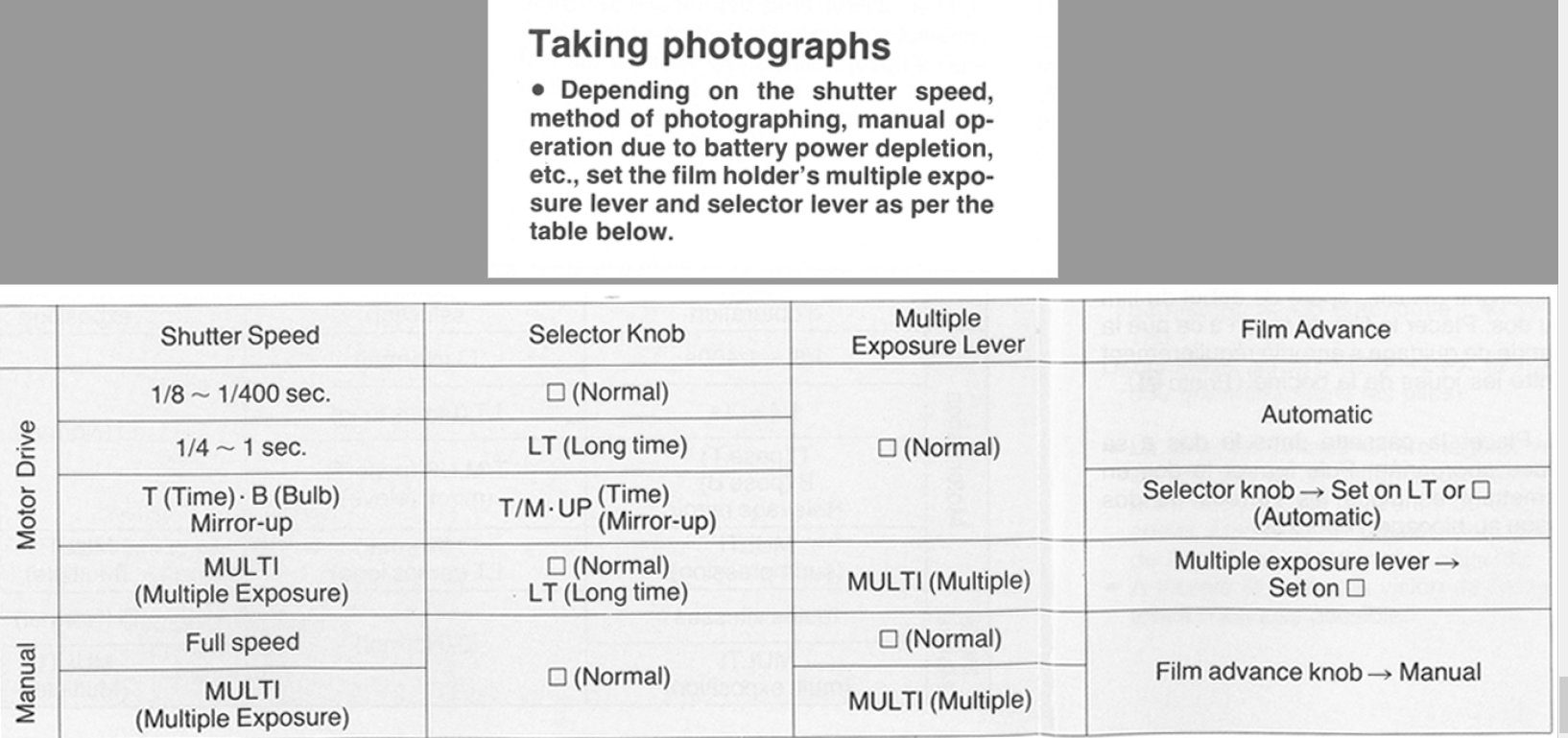

I've got a 6x8 back ready to go on my new RB67 SD. I've looked at the instructions but I'm still puzzled by the selector switch on top. There's a square white box, followed by settings for LT and T/M.UP. Can someone explain what they mean and how to use them?? Thanks.
MattKing
Apr 24, 2005
52,331
Delta, BC Canada
Do the instructions you have include this table?
