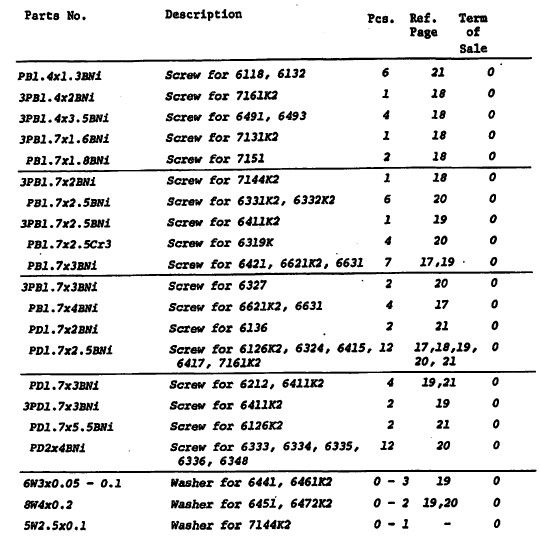

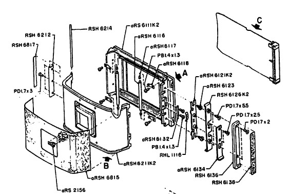

Which screw(s)?
I guarantee you they are metric and the part numbers appear to be the size and length in millimeters.
PD1.7x2 is a 1.7mm diameter x 2mm long screw and PD 1.7x2.5 is a 1.7mm diameter x 2.5mm screw.
I do not know if these will work or not.
http://www.metricscrews.us/index.php?main_page=index&cPath=98_298_299
You may find some screws that work in an eyeglass repair kit.
https://www.amazon.com/s/ref=nb_sb_...t&sprefix=eyeglass,aps,414&crid=2ETX0IGQ2HHM4

Thank you kindly Shutterfinger for taking the time to post this information. This should help me in the quest to find the right screws one way or another.

Sorry it took a bit of time to give a positive and final update here. I tried various avenues once I had your solid input and especially the exploded diagram that Shutterfinger provided. In the end it was KEH to the rescue. A special thank you goes out to those folks. They asked for a photo of my pieces and what I was trying to accomplish and once they had that information they immediately shipped me the 3 micro screws. I received the screws in postal not more then 1/2 hour ago and the repair was made without any issue beyond my horrible eyesight and trying to see well enough......:cry:
