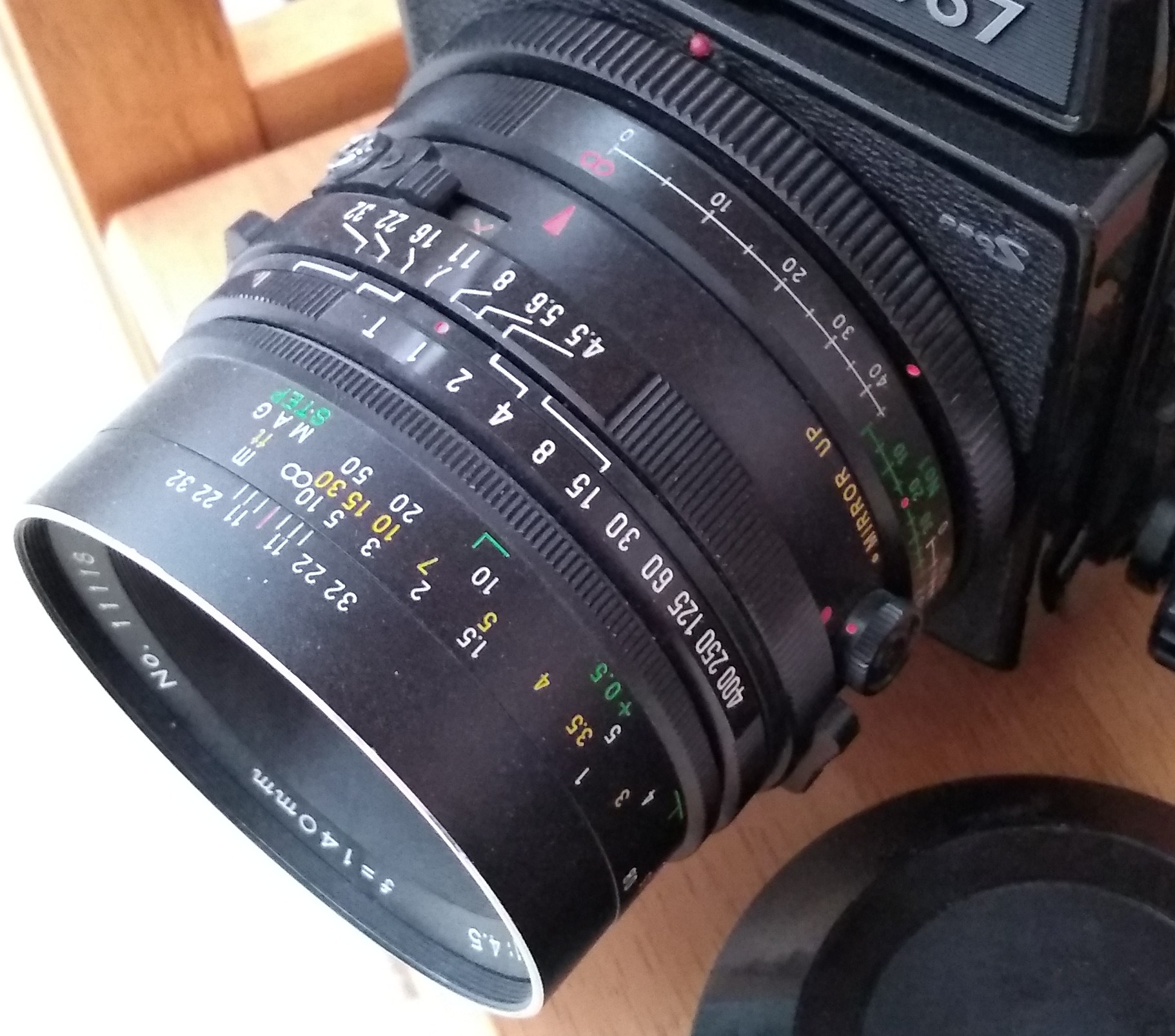

The main reason that I remember why I bought the SD was the Depth of Field scale on the SD has lense(s) that the Pro-S doesn't. I know the 140mm wasn't listed on earlier model RBs
The depth of field scale does exist on lenses used by the Pro S, see photo. The scale is at the front of the lens - some people may think it's a focusing ring, but it's not since focus is done by the bellows and body.
Jun 7, 2005
800
Torino, Italy
I Believe Lanline was improperly referring to the focusing scale / correction factors plate on the right side of the camera body (which is not a Depth Of Field table).
However, to illustrate your point you picked up possibly the only lens that you shouldn't pick up, as in the 50mm the front "focusing" ring is not only a slide rule for DOF but it actually moves a floating element in order to get maximum resolution according to the focused distance.

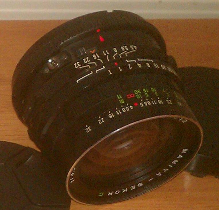

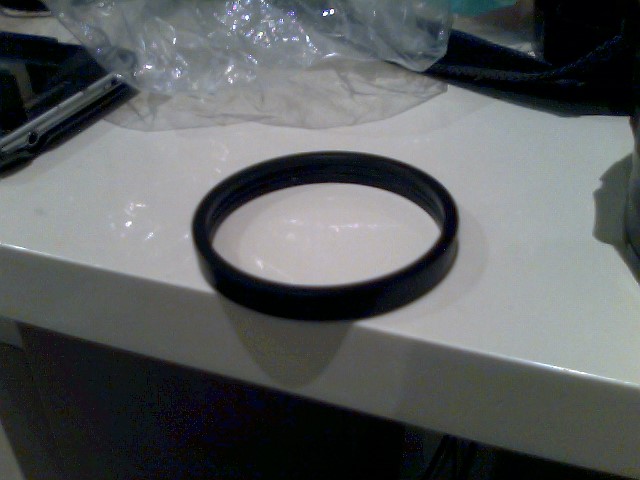

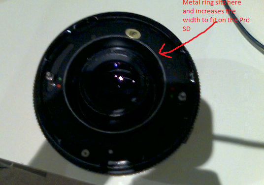

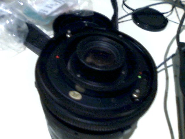

Hi
I have both a RB67 Pro S and a Pro SD and put a few rolls in both of them. The Pro SD is more lightweight and as mentioned earlier in this thread, a larger 'throat' in the camera body, if you were to use older lenses on the Pro SD you would need a metal ring that sits on the second ring surrounding the lens element (Image should help provide insight). With the modern RB67 KL lenses the will come with a detachable ring that sits in this position. The Pro SD film backs also have no light seals either, which is surprising. This is because of how the film back is made of a strong plastic that ('m assuming) overlaps and prevents any light from getting in. The Pro S model is heavier and the film backs have light seals in them. The film backs for both of these cameras can be used on a different body (Pro S film back on a Pro SD). Each body will also accept the same finders and focusing screens so you could swap them around if you want to. Both of these cameras function exactly the same, just for these minor differences such as less weight and needing a lens adapter ring. I hope this information can help you in any way. Attached are some images of where the lens adapter ring needs to sit and the ring its self.
Sorry if these aren't the best images.
Yes. Correct. Also the 140mm also has the floating element.
Theo Sulphate
Jul 3, 2014
6,489
Gig Harbor
Good point. Here's the 140mm lens, showing floating element ring at the back and DOF scale at the front:
