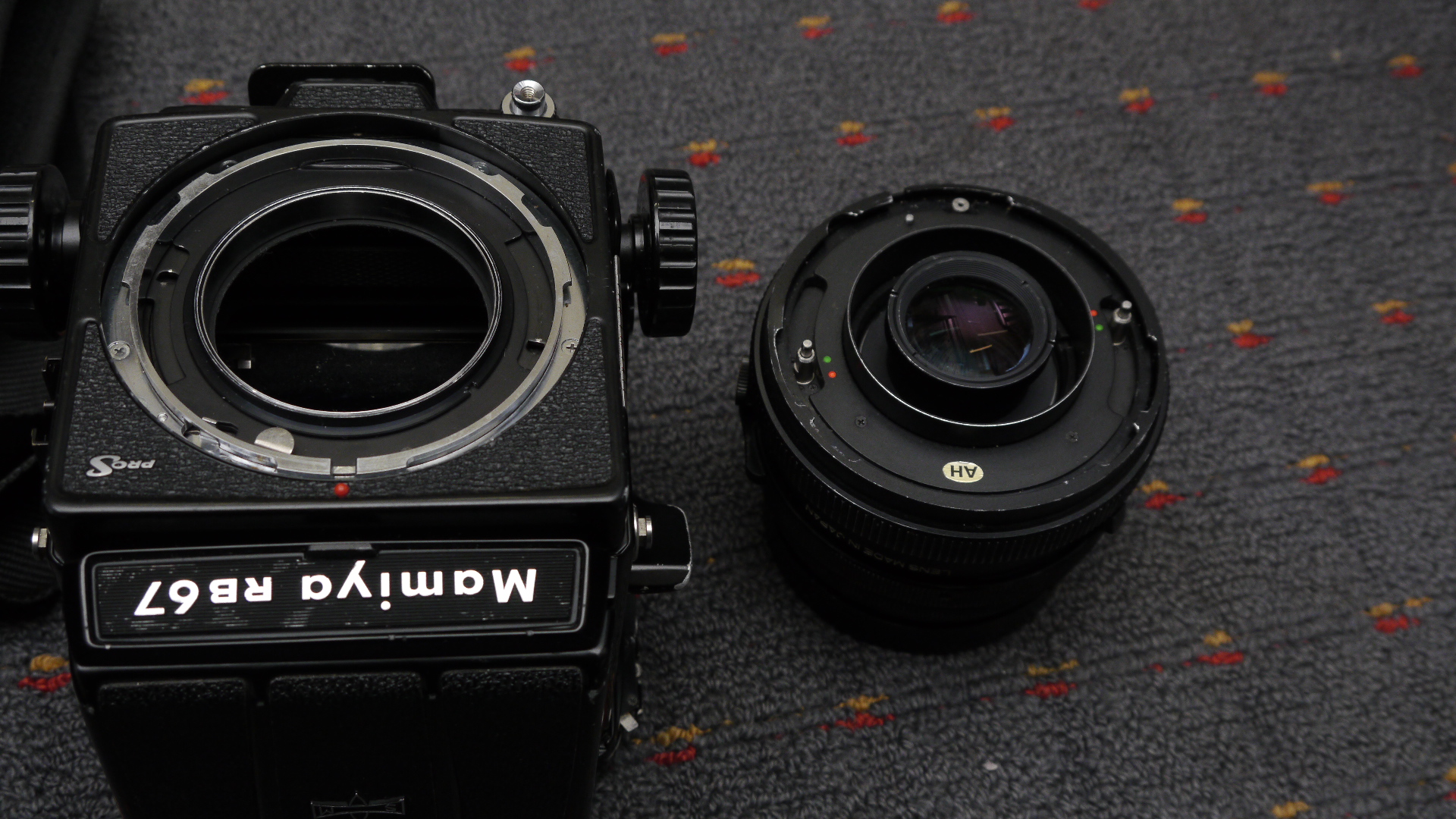

The 50mm couldn't focus that far away, it looked, it is not the viewfinder/screen/etc (using WLF), as the bellows were racked all the way back and can't go back any further. The focus in the image (Developed neg) looks at about 3m at the infinite focus setting. In the viewfinder I think it did look further down, very close to my subject, but just shy of it -I think-.

Now I don't think it's the mirror/screen/viewfinder etc being out, because being racked to infinite with my object at ~10m, but having focus closer than that indicates the lens needs to be closer to the film.

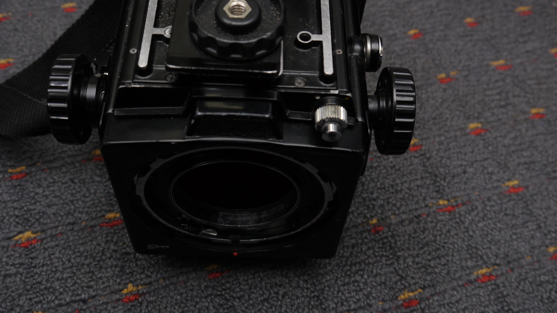

But there is nothing obscuring the bellows from closing to minimum extension, and it sits flush at the bottom where it touches the camera body when closed, so I dont think its possible for the bellows aren't being drawn all the way in.
I think the lens mount itself is protuding/extended as that doesn't look possible for it to happen.
When I mount the lenses they are secure and there is no play at all.

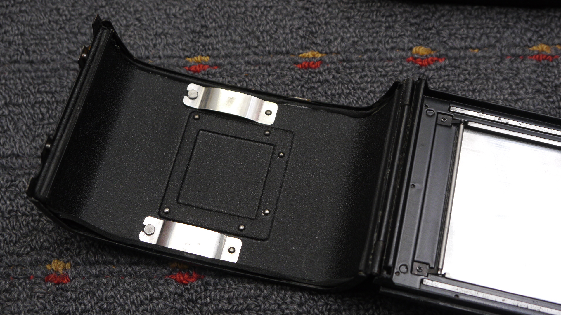

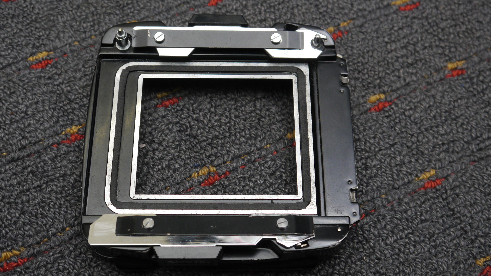

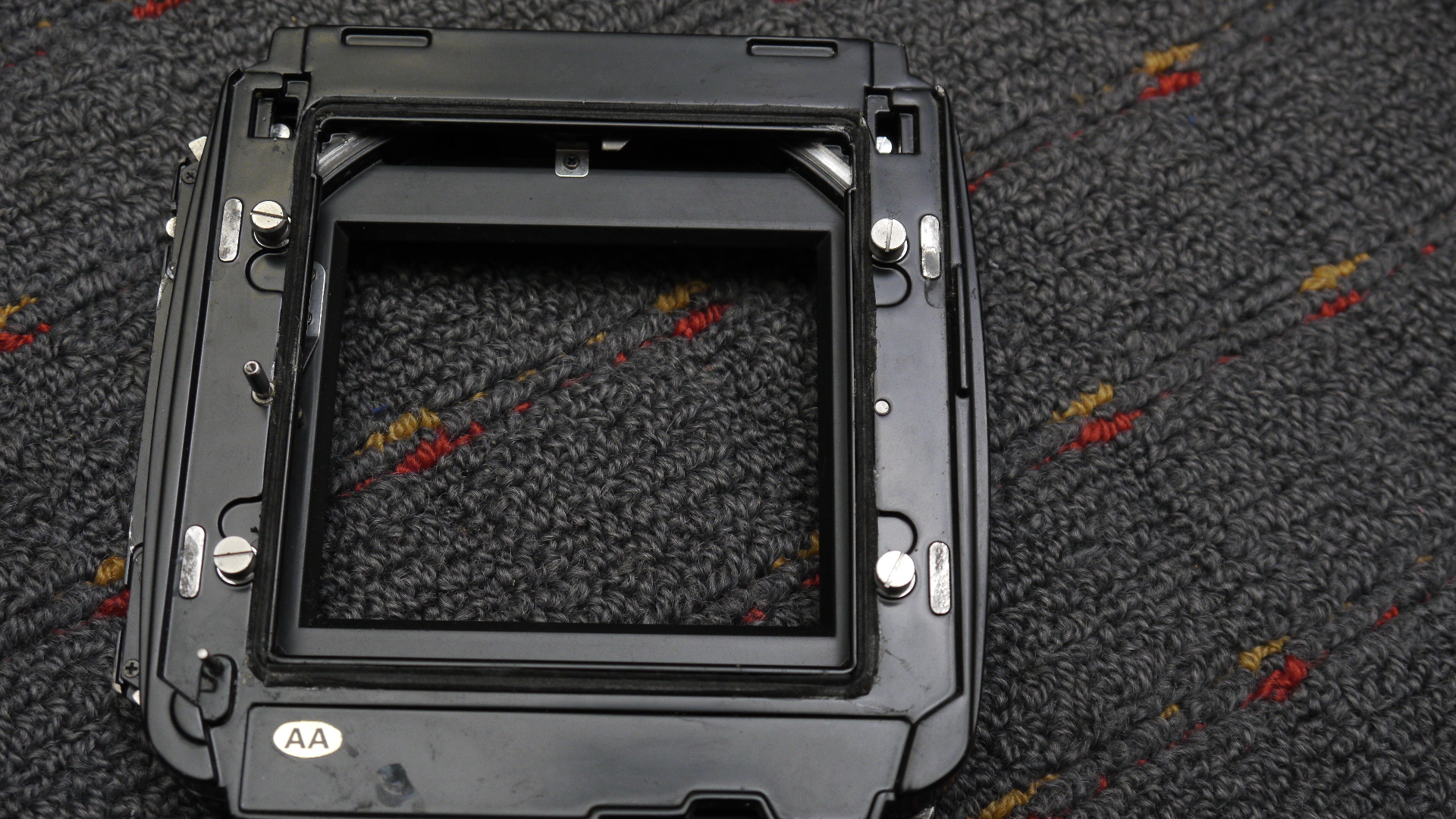

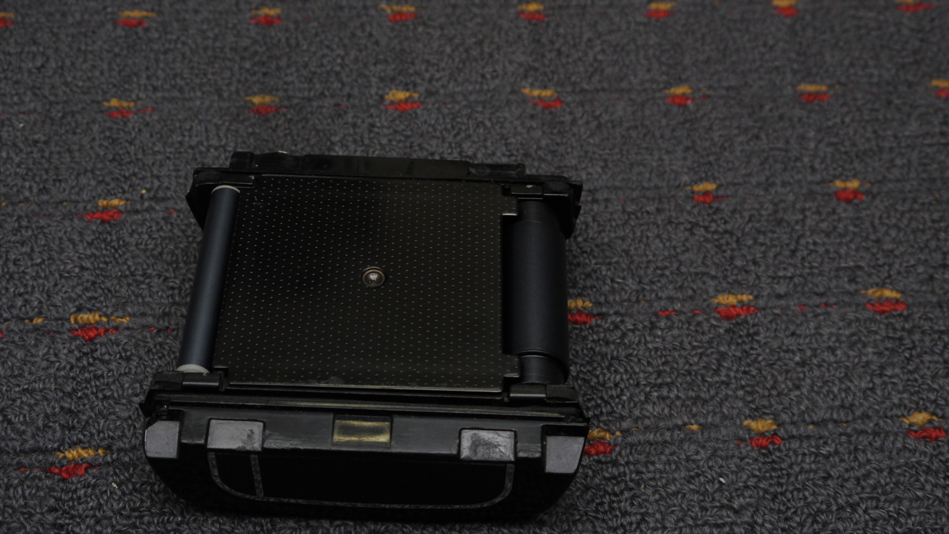

Now the back I used put some foam seals in it myself (inc the revolving back). I didn't do the best job, but it seemed to be fine at the time, so I'm wondering if I'm pushing the back or part of the back out a little to throw the film plane off (as well as the lenses/mount being out somehow)

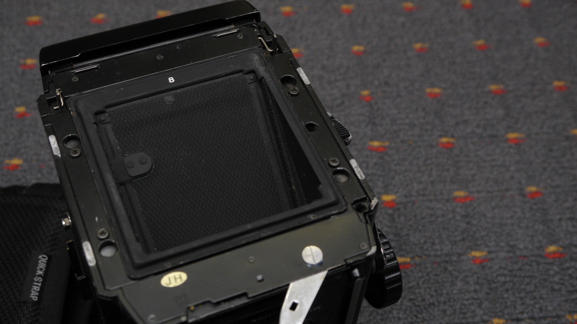

I'll attach some pics of that.

The foam in the channels on the rotating adapter does look fairly high.

Your viewfinder is not set at the proper height. There are 4 adjustment screws underneath the ground glass that you can use to set it correctly. Use another ground glass or tracing paper at the film plane with the film back on the camera, open the shutter and focus to infinity - as in something at least 100m away. Make sure that the image is in focus at the film plane first, then drop the mirror and check focus in the viewfinder using a loupe or the magnifier. Adjust as needed. Test all your lenses at different focus points after infinity is set. Focus errors at close distances with the 180 are more critical than far distances with the 50. I noticed my RB was focusing about 6 inches in front of my subject so I had to do this. Once done, everything looked as it should with every lens.

Additional thickness of the foam shouldn't matter unless it interferes with installing the back. You could(if you had another back) measure from the lens flange to the film plane to verify your accuracy.

I shoot close with the 180 a lot, it makes sense that the back or revolving back is set too far away (foam seals) + viewfinder being out too.. focusing closer due to VF error and back being too far out compensating for that in some cases.

I assume you mean the screws with two holes in them, and not the philips head screws?
How do you adjust those? As in, looks like a special driver to do it.
I cant find something that small, we have a tool like this but it just doesn't fit.

Fixed the back issue I think, was the foam around the revolving back. VF seems pretty close with it now, but dont think it's 100% focused at infinite, looks pretty close though, I need a sharper ground glass than my make shift one to tell though (Even with the loupe it was hard).

Also if you are going to mess with the spanner screws (large flat head with 2 holes) you should make a small reference scratch on each head to teh body so if you have to go back you can undo your screw ups.

Your foam seals wil not effect the focusing as much as you think.. the difference is so small nad the way it locks it will force it to the minumum thickness or it will not lock!

Yes, I believe so. I haven't looked at it in a while. A couple metal tip mechanical pencils or maybe even paperclips would work. I usually use a couple metal pointed picks.

The spanner is very common and sold in Home Depot.. spanner drivers.. come in tips for magnetic holders and also in sets for security screws.

I ended up having to raise the screen with blue tac on the shims/screws.. because they wont go that high (probably). Which is a problem, its well out of infinite focus, at least on the shorter lenses.
