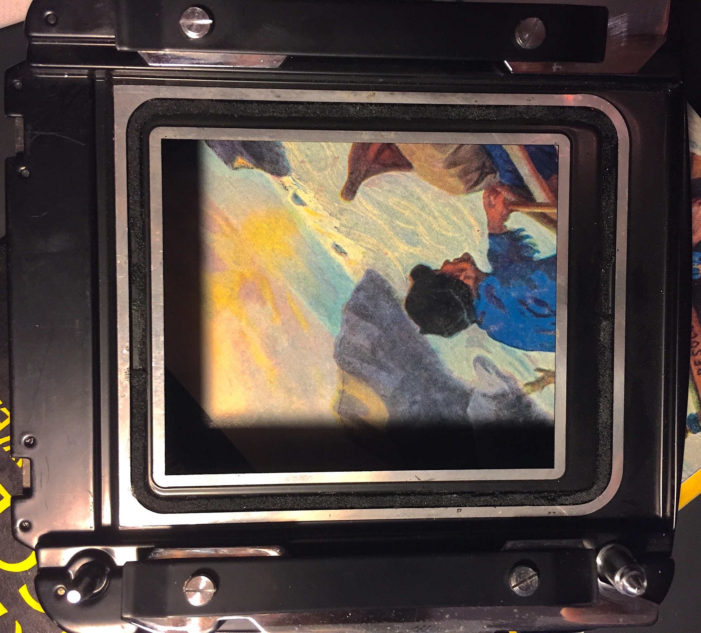

  1. The light seal around the body where the film back attaches is totally funked and I noticed the seals around the mirror came off if I blew on them. I'm going to replace the seals around the back of the body; would it be worth replacing that around the mirror and also where the darkslide enters the film back while I'm at it? Would this all use the same, 2mm open cell foam?

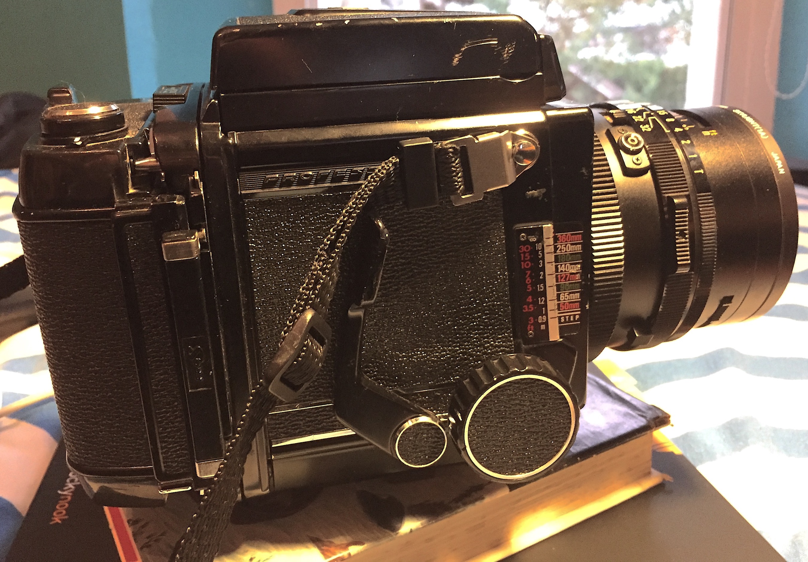

  2. I bought an OpTech medium format camera strap with the type B connector (after a full day of handholding the thing around London). It fits great on the camera but I'm just worried about the lugs and whether it's going to snap on me - should I be worried? What's the failure rate of this thing like?

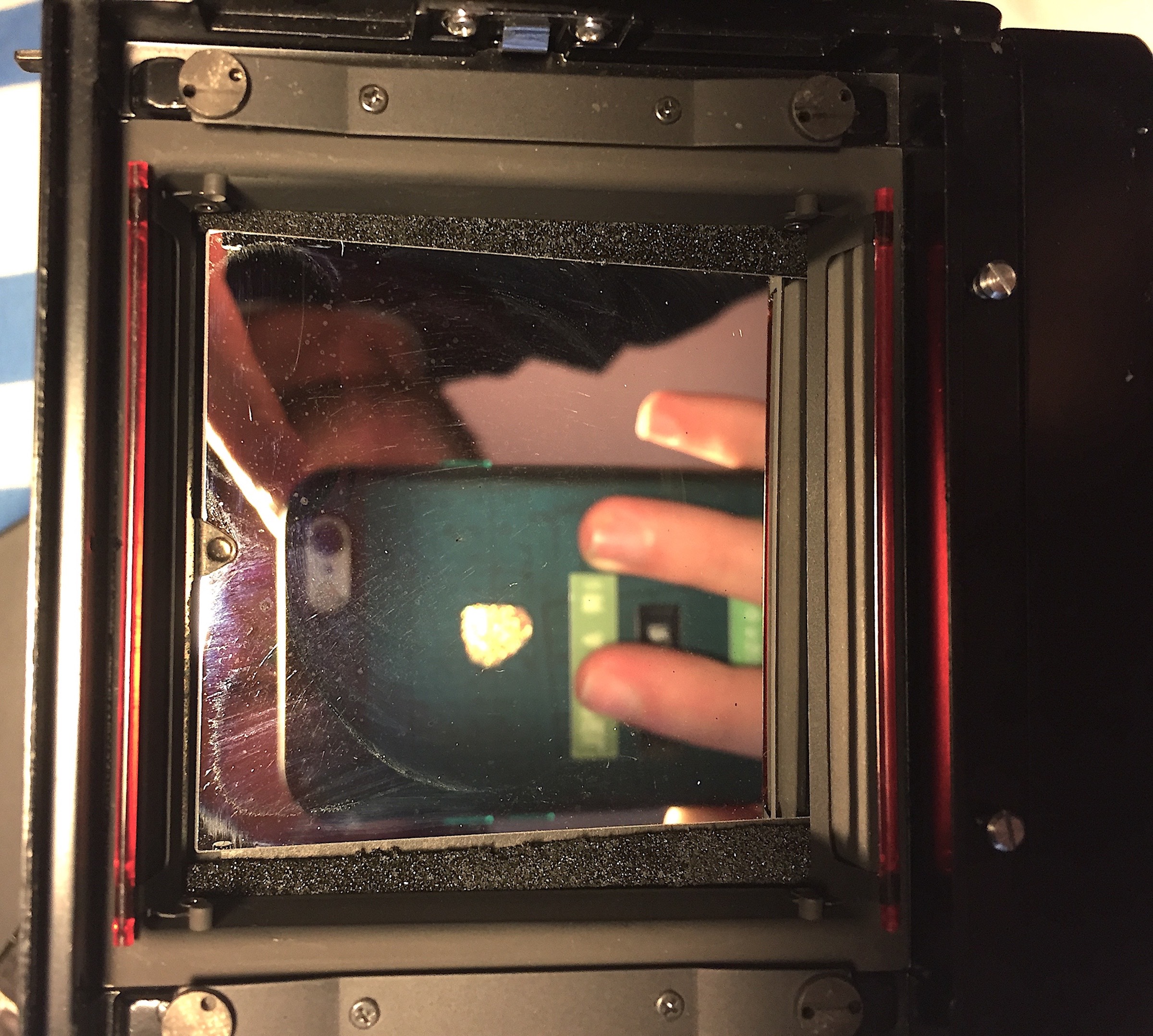

Ive refurbished quite a few cameras, usually with 91% isopropyl alcohol for cleaning old foam seals. For cleaning dirty leatherette, I just use water with a little dish detergent, and either a cotton swab or a soft toothbrush. Work on small areas at a time, and use *just enough* fluid.
When I built a single working RB out of two thrashed ones, I replaced all the seals, including the dark slide area.
Is the leatherette what the bellows are made of? So the isopropyl will get all the horrible foam out and then I can just stick my new foam in. Do you know what the foam situation is in the darkslide slot? Is it just the usual glued in?

Strap and lugs are solid. I have the same or similar strap and have used it for years. I just shot a roll of film with my RB67 Pro S with badly deteriorated light seals and had no problems in the image area. Some *very* minimal light leaks on the edge of the film outside the image frame.

Replace all the seals. If one needs replacing, the others aren't too far behind, and other then the mess, they're relatively easy to do.

The lugs are strong, I'm always more concerned about the actual strap being strong enough, but after 3+ years, I haven't had any issues.
Do you have any advice on doing the seals around the mirror/darkslide? The one for the adapter seems relatively simple, but I'm not really sure about the other two - especially the darkslide one

Jon Goodman used to sell really inexpensive kits with all the seal material cut exactly to size, accompanied by detailed instructions: http://www.kyphoto.com/classics/sealreplacement.html
Jon is great to deal with.
Aye, I just emailed him and he replied within like 6 hours - what a gem. He says it's going to be ~$40 for the seals for the mirror, adapter, and 120 back - which tbh seems quite fair seeing as it includes postage from the US.

2. I use a strap that attaches to the tripod mount, like a QuikLok strap. It is a good alternative and the RB becomes easy to carry.
